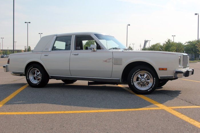

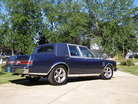

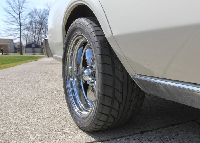

Hows it going guys trying to build My daily driver that looks like a hod rod out of my fifth avenue. Can anyone help me find out what set of american racing tourqthrust will fit my 1988 fifth avenue if there are any at all that will fit or a set of rims that look similar? I know there is a fella that has info and pic below
  • Tires are 255/50R17 BFGoodrich KDWS's, wheels are '01-04 mustang bullits but other than that idk what size or offset or anything any insight would be much appreciated I wouldn't mind these rims right here if anyone can track em down that would mock right up no problems

That's Patrick's old car and was a heavy influence on my build. Coincidentally we're both in Michigan as well.
I'm out right now and will post specifics tonight. Rims on my care are VN515. What size are you looking to go?

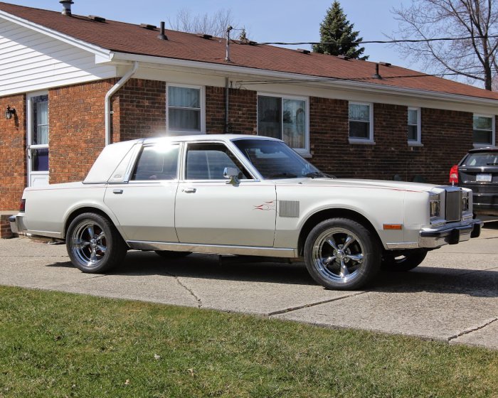

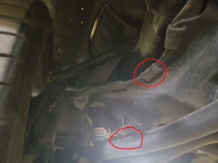

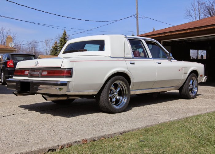

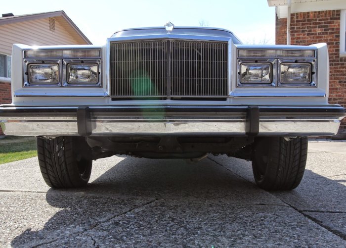

Fronts: VN515 18x8 4.5" BS 245-18-40
Rear: VN515 18x9 5" BS 285-18-40
The rears will occasional rub a tiny amount in the top of the doghouse. I tried finding a photo, but no idea where it is. The fronts will rub the torsion bar and k frame at full lock if you go any bigger.
Now the ride quality will go to absolute pot if you do this without upgrading other areas and spending a chunk of change on shocks. I have stiffer springs on the car (5 leaf rears and 300# Firm Feel bars in the front). To get the ride quality back shocks I put double adjustable Viking shocks on all four corners. Honestly it rides better than factory, but those shocks are a grand for all four.
I wouldn't go larger than 17" and maybe square it off with 245 tires on all four corners.

Go with a 15x7 wheel and use 235-60-15 tires on all four corners. 255 *might* fit upfront, but it'll require measuring. This way you can rotate the tires. BFG Radials with raised white lettering.
You're on the opposite side of the state from me. I'm north of Detroit.

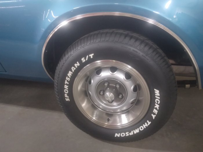

If I can interject an opinion, one of the best things I've done is replace the BFG's with Mickey Thompson Sportsman S/T. Made a huge difference in ride, handling and traction. Like a whole different car. Your results and opinion may vary :)

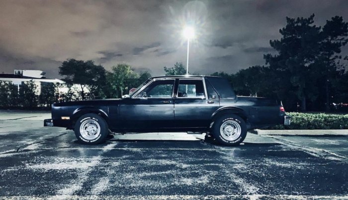

My experience is a bit dated in what's available in 15", but this is the style that I was thinking of. I would take Aspen500's advice on the tire.

Crager S/S is always a classic look too. I had these rims on the 5A before the 18" Torque Thrusts.
