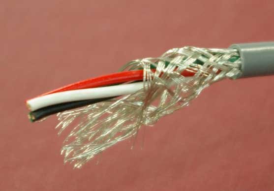

I do highly encourage to use shielded wiring for your fuel injection system, to protect from electrical signal interference.
