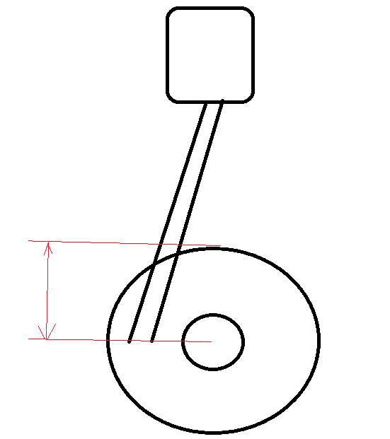

Ok I have been thinking here and thats a bad thing, the piston weight is the piston weight, the webbing weight is there to balance the part of the con rod that is in the webbing, I don't think you balance the pistons to the crank, aren't sort of just balancing that bit in the red to the crank, don't they some how weigh each end of the conrod to work out the bob weight, they don't stick the whole piston and rod weight for the bob weight. All they want to do is make sure the pistons are all the same weight and the rods are the same weight then they set the crank up to balance with a part of the conrod??

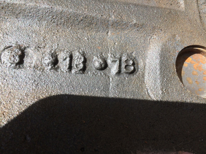

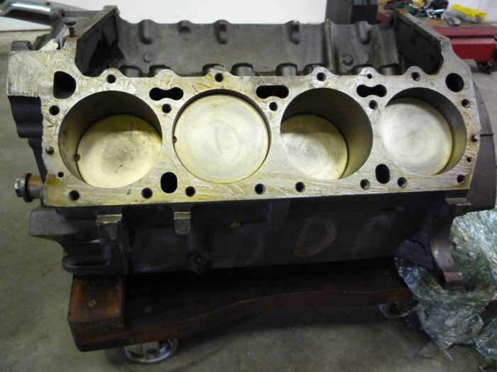

I have two new 400 short blocks in my garage. You can see numbers hand painted on the sides of the cast iron blocks:

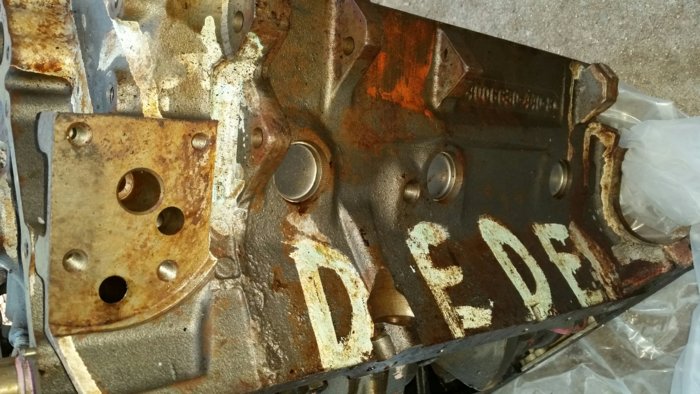

After the factory builders bore/hone the cylinders, they measure the holes and mark the size as a letter. In this case “C”, “D” or “E” as shown. Then they go a roomful of pistons (with pallets marked “C”, “D” or “E” and so forth), retrieve and place the pistons on a tray (in order) so the rods can get pressed in.
It is possible the pistons gathered might be made a month apart or even from a couple different venders, sometimes. I have removed pistons from these engines (back in the day) that are evident there were 2-3 different style pistons used – so there might have even been compression differences as well (I didn’t look that hard for I was getting paid by the job, not by the hour). I would say most factory engines are a long way away from being close to factory specifications.

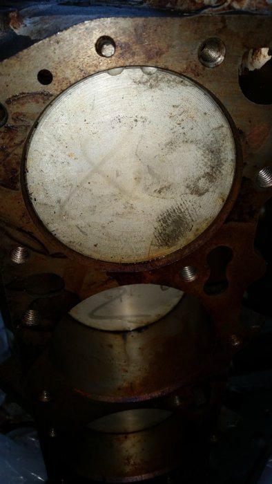

If you look closely, you can see “D”s handwritten on the piston tops (but covered with cosmoline) and one notch indicating front of engine.

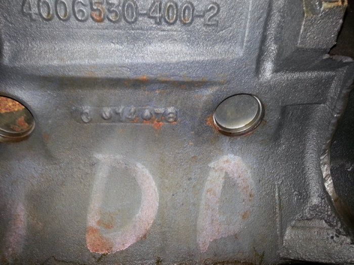

Now look at this (the other block), This one has two notches indicating front of engine. The lower piston you can see a “D” (or maybe a "C"). The top piston might be a weird “D”, maybe (not sure).
What I’m trying to get to are both engines are using different (brand, maybe) low compression pistons. Both are brand new short blocks. The blocks cast within a day of each other (one on 3-13-78 (see top picture, above) and other on 3-14-78) – but not sure of machining date or assembly date (not looked). There might have been a couple of weeks of the blocks being machined and/or assembled. It is hard to have two different pistons weight in at same amount – even from the same casting. Even notching the pistons will make them weight in differently.
Also, one block has a heavy coat of cosmoline on it and the other, not so much.

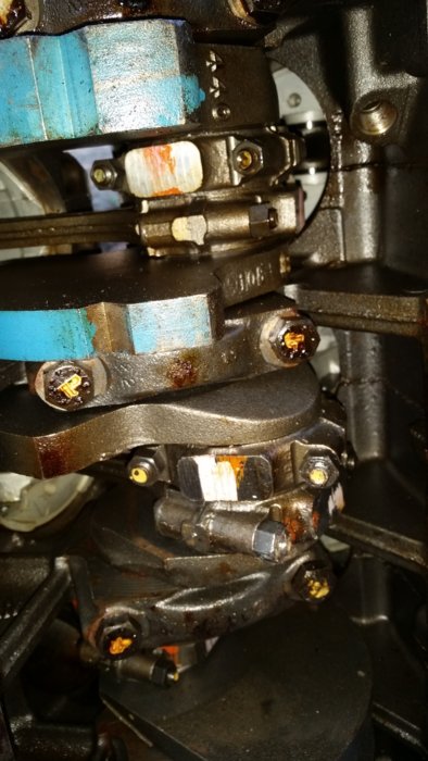

On the underside, there is all kinds of paint markings on it. Each main cap bolt and rod cap nut has a dab of paint – which I would assume verified it is at correct torque. The crank has a lot of blue, which I suspect means a 400 with cast crank with normal rod/main bearing sizes. The connecting rods have orange paint on them – which I assume is standard size bearing inserts installed. I think it is interesting on the story each of these engines have – but once you paint the outside of the blocks and coverup the pan – that story is gone.
