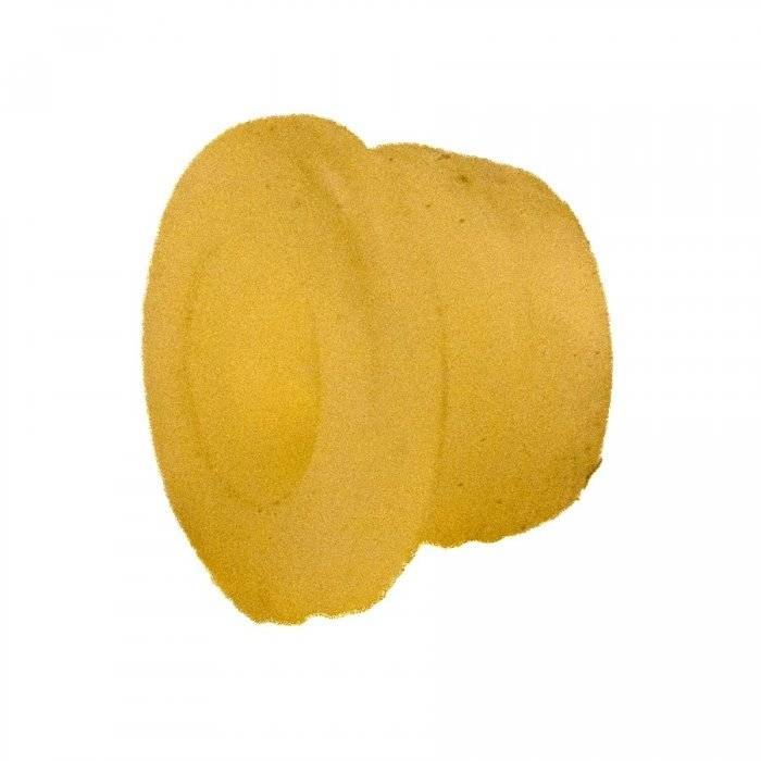

- Also the rubber bushings/grommet (push/pop in), between column to Z-bar is to be replaced anytime they are disconnected. Part number 3575333 $5.20 each (US) from Dodge (I found a lot on eBay, using part number TO-41). There should be 3 or 4 of these, depending on year built.
Looks something like this:

The pop in place bushings (above) are about ½” outer diameter and ¼” inner diameter (again, approximate – going by memory).
The pop in place bushings is said to replace each and every time the rod is disengaged from bushings. I have reused these several times – but I have also had these bushings crumble on me, as well.

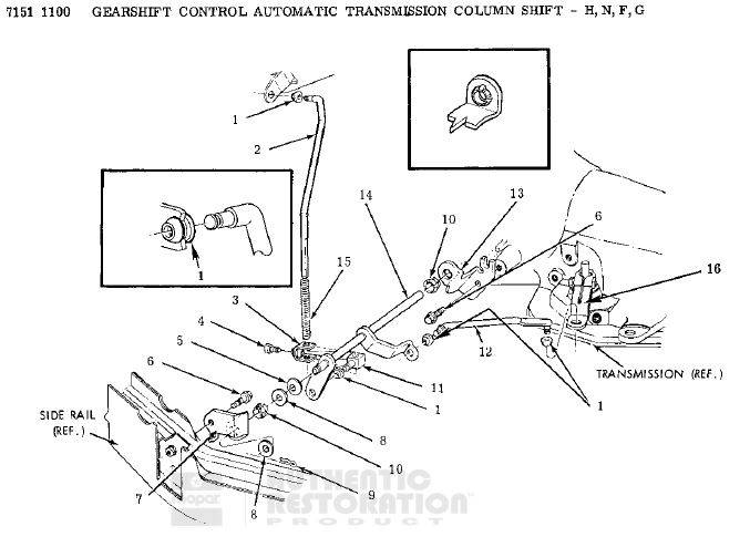

As to the original question, the linkage has had some changes over the years. If you change all components from one donor car, then you should be fine.
From my '77 parts book.
From my '84 parts book.
