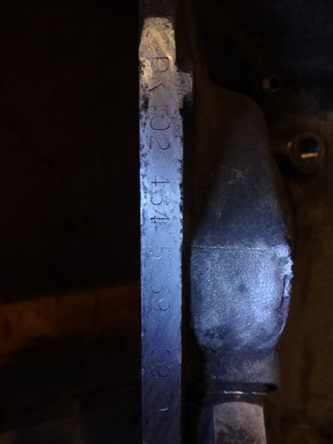

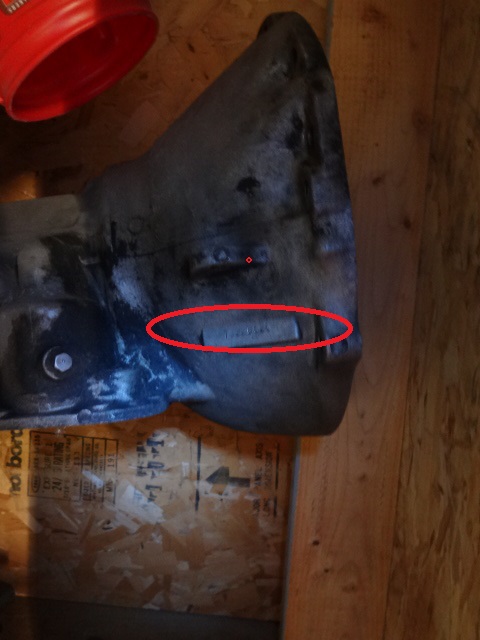

yea, yoke too. 727 trans should be about 3 inches longer. should be some stamped numbers on the pan rail IIRC

Passenger side vin stamp pad, trans info on drivers side pan rail.

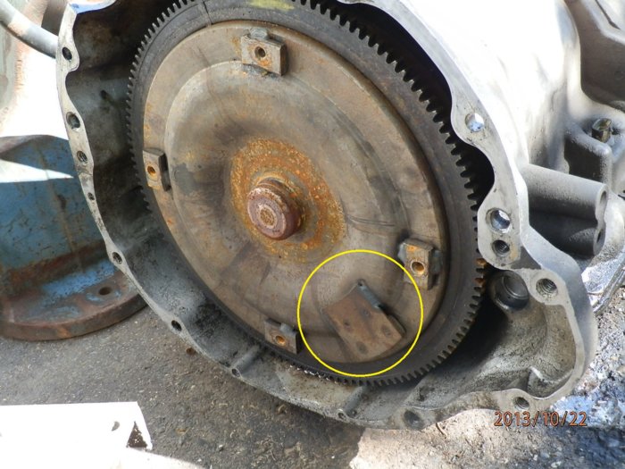

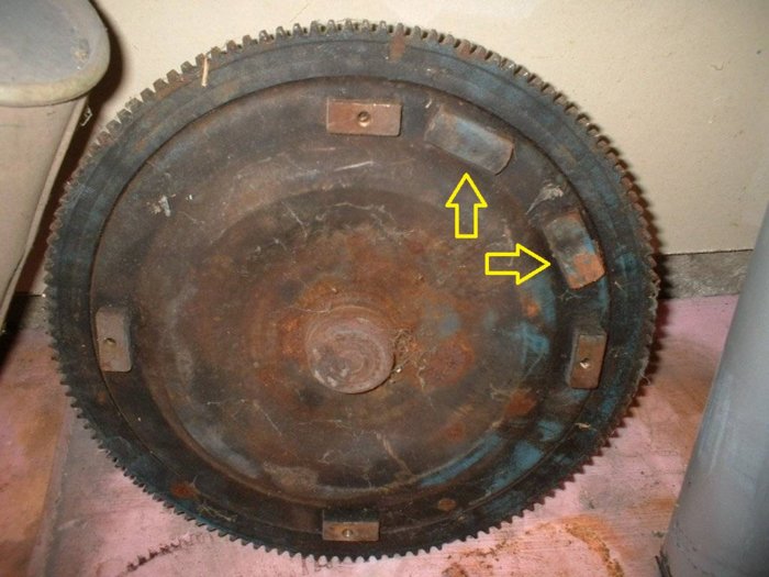

The 360 engine is externally balanced and there is a weight spot welded onto the converter for 360 engines.
If your 360 is going to remain stock (ie: no aftermarket stroker kits or anything) and if your (existing) torque converter does not have a weight welded onto it, then I would highly recommend getting a balanced flexplate (like below) and use a “neutral” balance converter (like what 318’s use).
Here are a couple versions of 360 balancer weights. There are other versions as well – but you will tell that it was added on for a reason.

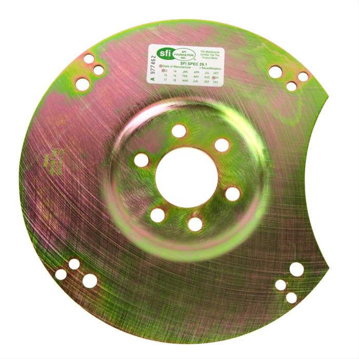

The recommended 360 balanced flexplate:

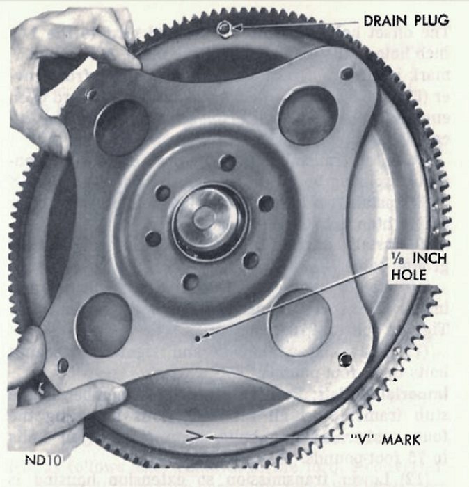

A few tips here. Non-lockup converters made before ~’76ish have drain plugs. All lockup converters and non-lockup converters made after `’76 (lock-up converters came out in mid-year ’78) do not have drain plugs (which makes looking at a converter and visually telling them apart, hard to do. The drain plug is not compatible with the lockup system sense plug is in the clutch plate piston area (has limited drainage).
Tip number one. Converters with a drain plug – the plug goes opposite of a small hole drilled into the plate (the drain plug is represented by a red circle).

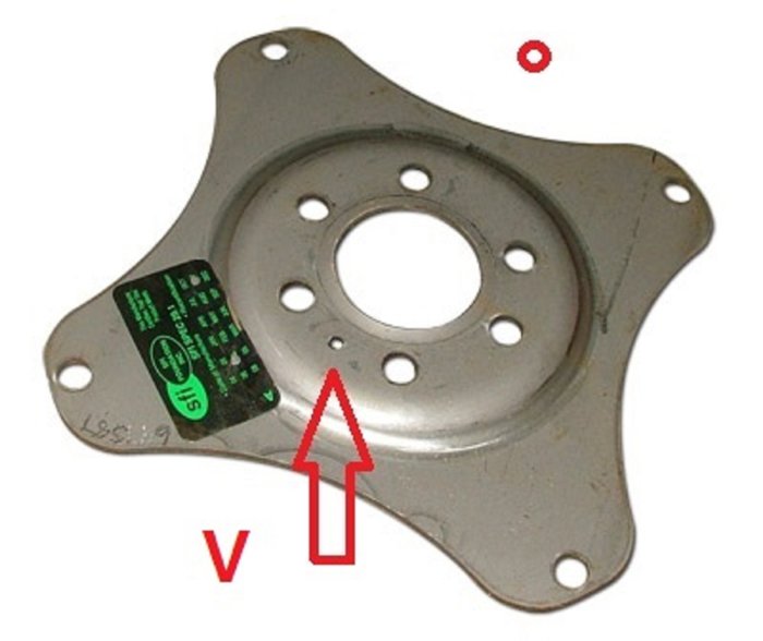

Tip number two: Most converters (not 100% but I’d guess that 93% of converters without a drain plug, has a “V” stamped onto the converter). The “V” is to be matched up with the dot/hole drilled into the flexplate.

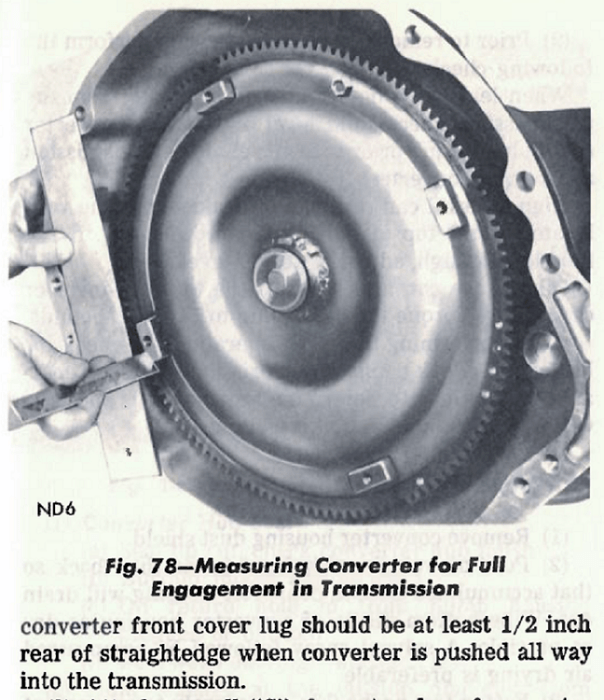

Tip number five: make sure converter is all the way engaged into front pump, before bolting transmission down. I have seen MANY a person break the front pump, pump gears and/or break the converter when just a bit of time to make sure converter is fully engaged first. It is just needless grief.

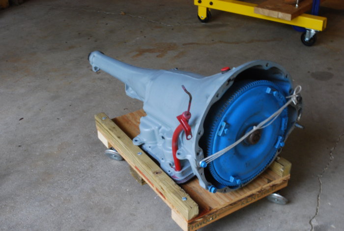

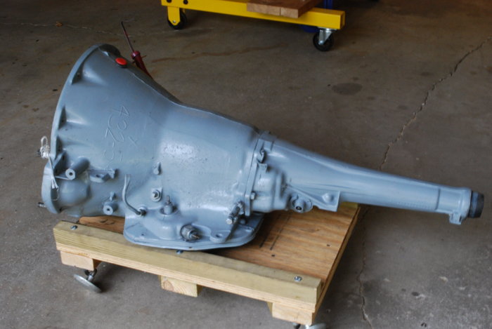

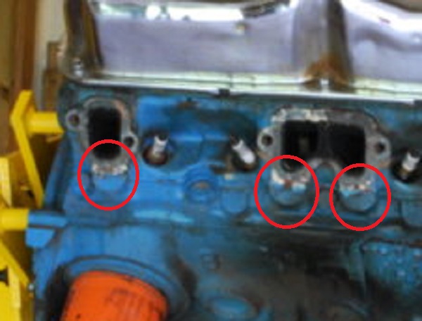

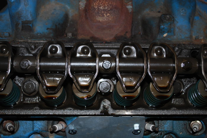

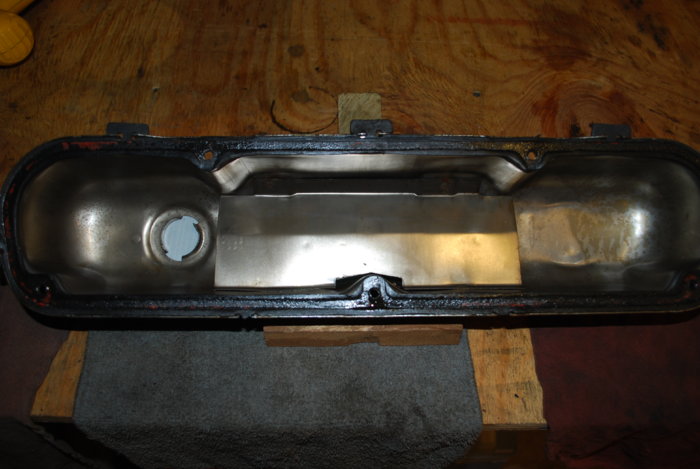

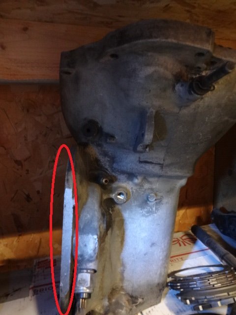

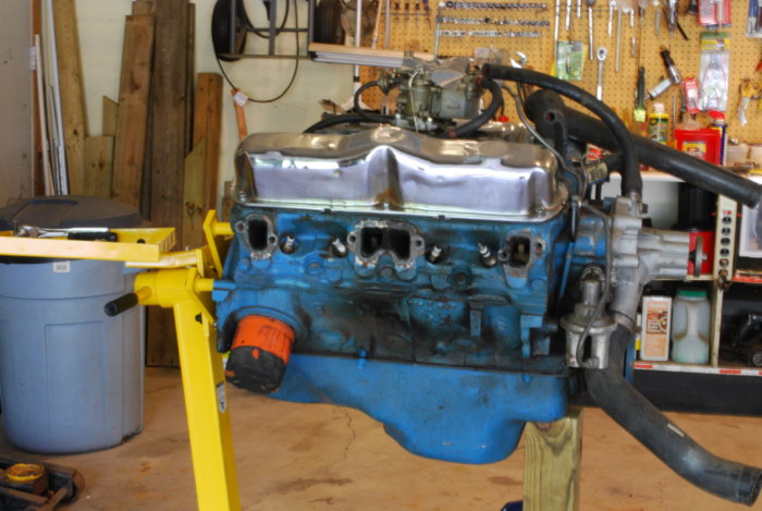

It's been awhile since I uploaded a photo but I'll give it a shot. These pics are from a year ago right after bringing the 360 and the 727 home. In these pics I've done nothing to them. No cleaning or anything. This is the state they were in when I picked them up. Everything was suspiciously clean. Especially the tops of the heads and inside the valve covers. This was an ebay purchase that happened to be within a 100 miles of Roscoe!
My observations:
A cool dolly for the transmission!
The transmission looks like either a used transmission because that someone spent time cleaning & painting, or a transmission shop rebuilt – because the two transmission cooler lines have been cut and crimped. Anyone removing a transmission will typically remove the transmission cooler lines using a ½” and 9/16” end wrenches (or better yet, line wrenches) – so they can reuse.
The neutral safety switch, speedometer adaptor and cooler lines are not painted (from the factory) – but nothing wrong if they did.
Generally, a transmission rebuilder will paint a transmission – but not install bent & crimped cooler lines on it (or might to paint with, then remove).
The transmission extension housing does not have a provision for a console shifter (not sure if that is a concern).
The dipstick tube (painted red) is bent towards the transmission and dipstick handle is bent straight (should have a loop type end). The dipstick and tube are different between A904/998/999 vs. A727. Also, different between /6, small block and big block (where the top bracket transmission engine bolt hole is at. Sense both are bent, I recommend you locate a small block A727/A518 dipstick and tube – eBay can be of help here. What year make or model doesn't matter as long as you get both at same time - and as long as small block A727 or A518.
This transmission has the recommended screw on speedometer gear adaptor – so you will need to either replace with your original clip-on plastic adaptor OR replace your lower speedometer cable to use this adaptor. I recommend using this adaptor because it is easier – especially if transmission ever must come back out again.
You will need to remove both adaptors to get the correct speedometer gear (tooth count) from old and to install in this trans. Note: the speedo gears are different between screw on and clip on adaptors.
I can’t see the harmonic balancer to verify this is a 360 – but have no reason to doubt it.
It does have a “car” oil pan (which you will need).
Looks like a new (or newish) water pump.
I can not tell if the cylinder heads have the A.I.R. ports plugged or if no passageways were drilled to begin with. I do know it was using older exhaust manifolds because of the paint line where the A.I.R. ports are at.
In this case, you can use headers, older exhaust manifolds or even Magnum manifolds without any issues.
You can also use your original exhaust manifolds BUT your A.I.R. system will not work (because ports are plugged or non-existent). This could be a problem if your area performs emissions inspections. If not, then 2 thumbs up.
Be sure to scrape all of that paint off in the area or whatever you exhaust you use, might leak.
It has the 360 Holley 2245 carburetor – which I despise working on.
Unless you have no option but to use it, I highly recommend upgrading to a 4-bbl (any 4-bbl) over using this one – then sell this one on eBay (or similar) for at least a couple bucks (and a whole lot less headaches for you).
The intake is a 360 2-bbl only – but has 0 value. It will make a great door stop or wheel chock. Just don’t get rid of it before transferring any fittings or brackets.
Edit: I also recommend removing the paint where the transmission attaches to engine at. Sometimes a paint drip (either engine or transmission) can cause alignment issues and/or bolts loosening down the road. A minor but an issue I’ve ran across before.
It can also cause electrical grounding issues (with starter or other items).

Thanks for the input Bud! As far as the trans goes, I'm taking it to a friends transmission shop to have him go through it. I don't know if it came from a re-builder. I'm sticking to a column shift. Honestly, I was after the 360 and the trans was included. A youngster was going to put this into a car, I don't know what kind of car but he decided to go a different route. Meanwhile...his dad wanted this stuff out of his garage so the kid put it on ebay. I followed it on ebay for 8 hours. Nobody else bid on it. I won the bid at $500! I rented a Menards pickup truck and went down to pick the engine and tranny up at his dad's house. His dad had a fixed chain fall hanging from the ceiling. I backed in and he loaded it up. I have more pics of the engine and heads with the valve covers removed but I was thinking that I should do that in a different thread since this thread is about the trans. Oh and by the way, If anybody wants to rent a pickup truck from Menards, be warned...they run on propane! They told me that the range of a full tank of propane was 300 miles. My trip there and back was 200 miles and I was on fumes when I returned it!
