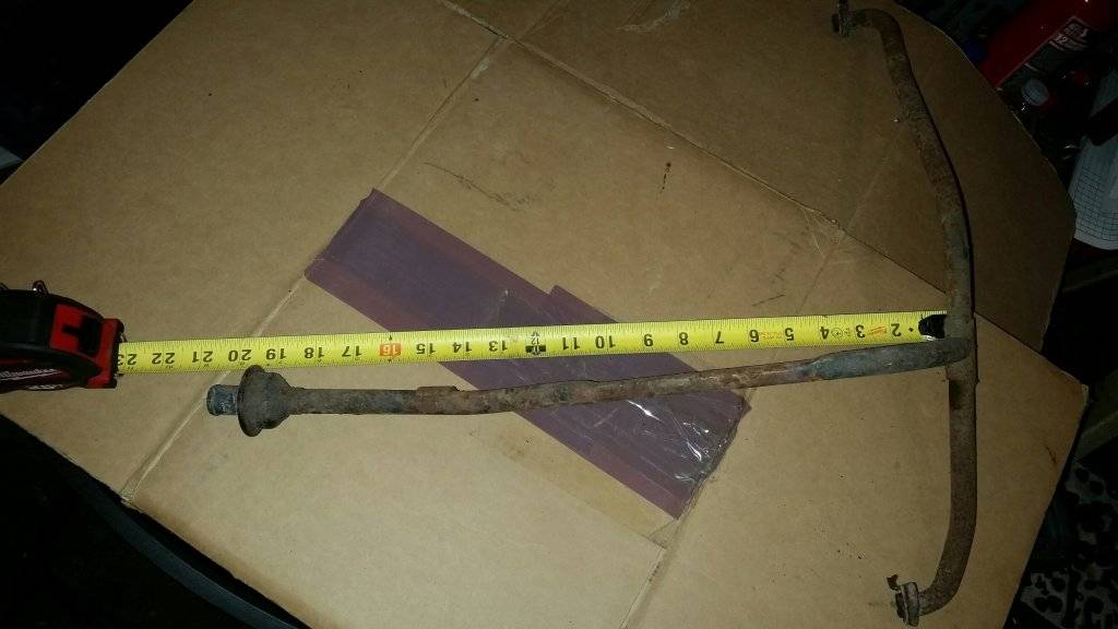

Okay, made it back to LKQ today and pulled this pipe off of a 82 van. Seems to match one of the air injection tubes I desperately needed. Its a type of bypass which feeds to just below the exit aperture on the exhaust manifold.

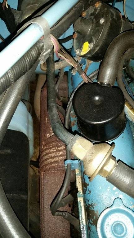

I'm still considering getting the air injection line which feeds both exhaust manifolds. There are a few Diplomats and 5th Avenues out here too Budw with the pipe you have. But that particular line is fed to the rear of the engine and manifolds on the driver side, not the passenger side like mine is. May not have to replace that one though, it might be in good enough shape.
But the pipe leading to the air switch valve (the one with the fang marks) I'll probably wind up pulling the original and having it cut and a new tube welded on. This 77 California version of emissions on these cars seems to be hard to find. Newer cars differ slightly.

I have 4 and ½ pipes.
Note: I didn’t intend to keep these parts - I just hadn’t discarded them yet.
Example A is from (I think) ‘78 360 motor home, maybe.
It looks to be in fairly decent shape considering its 40 years old.
Has a broken tab a few inches from the valve.
Example B is (I think) ‘84 318 4 bbl M-body, maybe.
The car had the intake and other goodies literally ripped off of the car, the other half of this pipe included. It is missing the valve and it appears to not came off easily (too hard to get a pair of plyers, I guess).
It looks like it could be welded on without problem. Part has about 50k miles on it.
Example C is from my ‘77 Volare 318 2 bbl, from New York.
The pipe only attaches to passenger side rear of exhaust manifold (and is not for sale). A reference picture only.
Example D is from my ‘86 5th Ave with 60k miles. It has two pipes, both fed from (the now non-existent) smog pump.
Both of these can be for sale soon - but it might be a couple of months still. I have to replace the entire exhaust system, and figured I could toss a few parts out while doing so.
Drivers side. I "think" this one looks like the '84 one, above.
Passenger side. This one goes to rear cat converter.

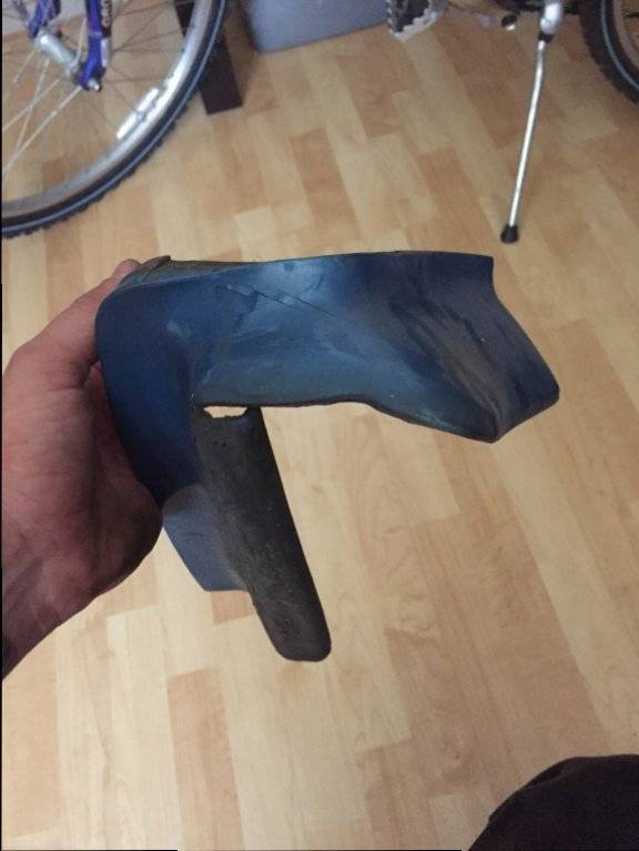

Been meaning to post an update for you guys, here are some bumper fillers I pulled off an ole Aspen at the pick ur part. I'm still in dire need of a spare compartment hatch and rear bumper shell. Not to mention all four running lights, amber and red. And of course, the air pump tube that crosses over between the two exhaust manifolds. It seems the 1977 year tube is pretty particular. Most all other years I come across have the air check valve on the driver side bank of the engine, not the passenger side, like mine. The car is insured and registered now, I'm hoping by this weekend she'll have brand new rubber on her :)

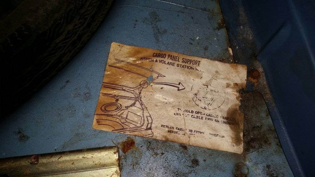

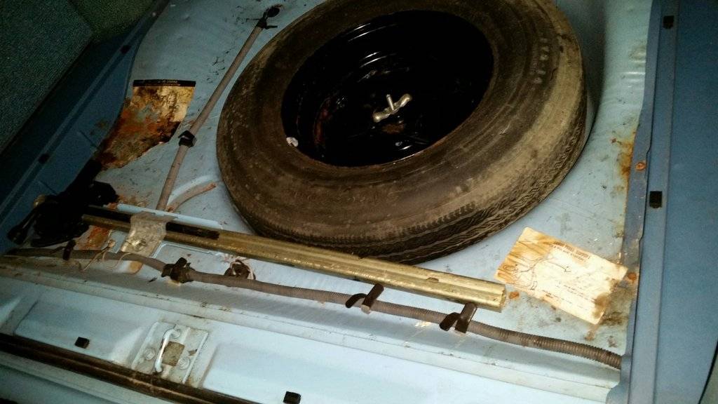

Trunk pictures.
When I first opened the spare tire cover, I noticed this item, and was thinking what in da world.
Then I read the paper instruction (like really, who reads instructions)?
FYI, this paper calls that a "CARGO PANEL" and the black cable is "CARGO PANEL SUPPORT".
My paper tire instruction kinda disintegrated.
I don’t think my F78-14 Firestone Super Belt Deluxe Champion (yes that is the tire name) spare tire has ever been on the road, nor does it appear the jack has been removed before (if it had been, they did a great job putting it back).

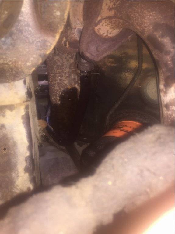

May 28, 2016
180
17
Westminster, CA
So i worked on the car yesterday, hoping to replace the water pump, thinking that was the reason she can't hold coolant. I discovered the timing cover has a hole rotted out where it meets the water pump. Thank goodness it didn't go inside the block . Am I correct that a 360 timing cover is identical to a 318 timing cover? I went and pulled off one from a van of the same year today.
