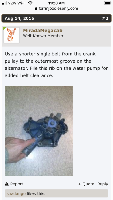

The car is all stock, 83k miles. Stock 904, 2.7 axle, blah blah. Looking for reliability, and decent mileage. I removed the A/C lines and condenser as it is inop, and after I find the correct pulley the compressor will go too. Also deleted the smog air pump. I just want to liven it up a bit to enjoy weekend cruising. In the distant future, I *may* do a swirl port head swap with a 340 cam, but for now, stock tiny heads and stock tiny cam.
