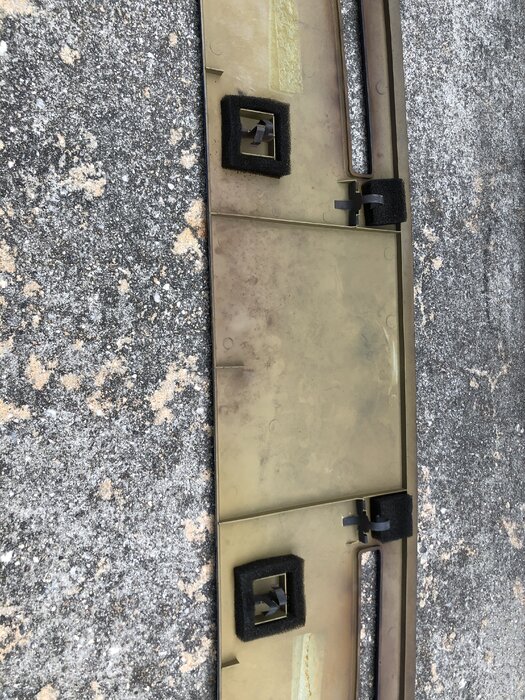

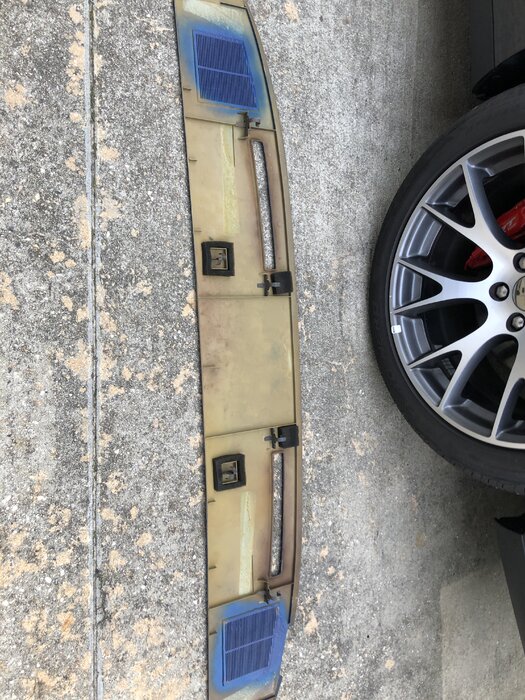

Thank you very much, I'm so glad that I dont have to take the dash apart!Pictured is the hard plastic speaker cover piece, upside down.
Notice the clips, especially the 2 that are closer to the soft dash pad.
Simply use a flat screwdriver to pry in between the soft dash pad and the hard plastic speaker cover, in-line with those clips.
Prying the plastic cover up.
