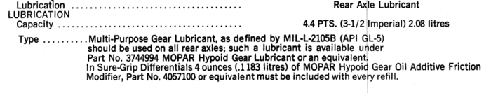

This is from my '80 Factory Service Manual (for 8-1/4" differential only):
4.4 pints - which is 2.2 quarts (or 0.55 gallon).
Limited-slip differentials that use clutch disks require additive. The cone type carriers do not use clutch disks and therefore no additive is needed.

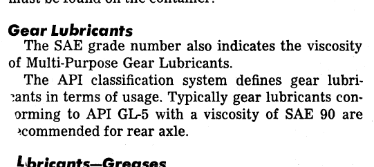

The above doesn't mention the weight of oil, so I found this, from the same service manual:
Hopefully this helps.
