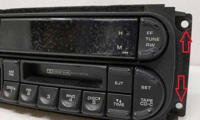

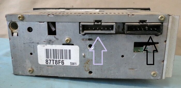

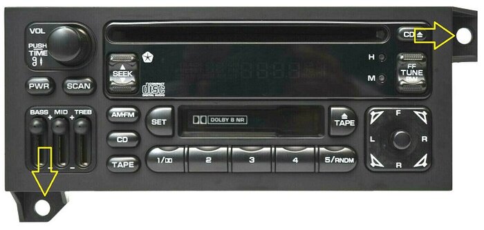

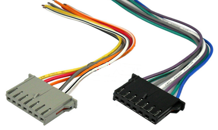

Close - but not quite. A few notes on what to look for. It is not too hard to adapt an older vehicle to use the "two flat plug" wiring with a bit of re-wiring on the car. I love the "two flat plug" pigtail design and it is a mostly universal (for Chrysler) for a long time.

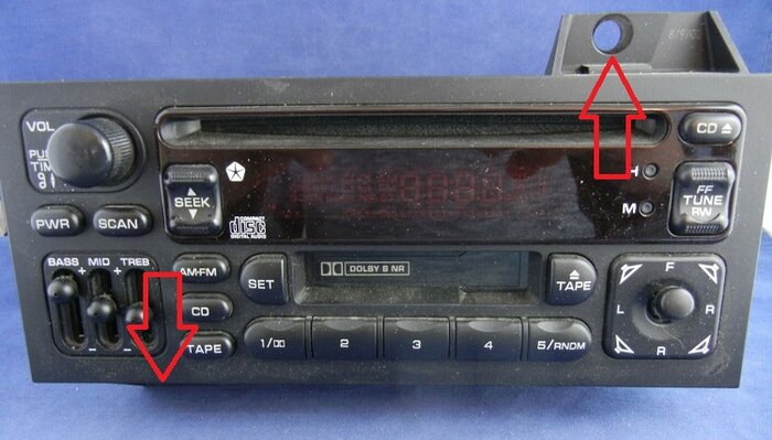

But there is an even bigger issue with interchange (ie: fitment).
This is the format that fits FMJ's:
The key is to remember this part over most anything else!

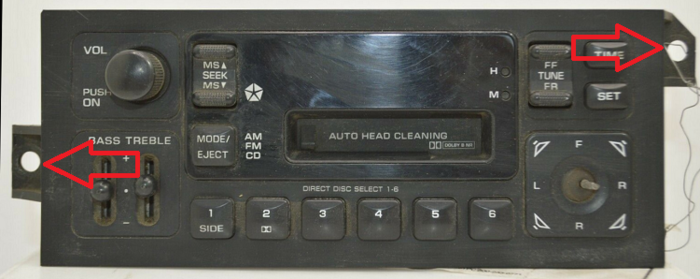

Other attachment designs are:
Both of the above are the same size/shape - but mounting points will not allow it to fit (without a lot of modification).

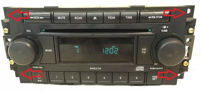

The new designs attach using 4 fasteners:
I call this the 4 fastener Square design.
And this the rounded corner design.
Both of the above radios use different wiring pigtails and require a lot of modification to fit.

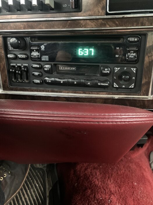

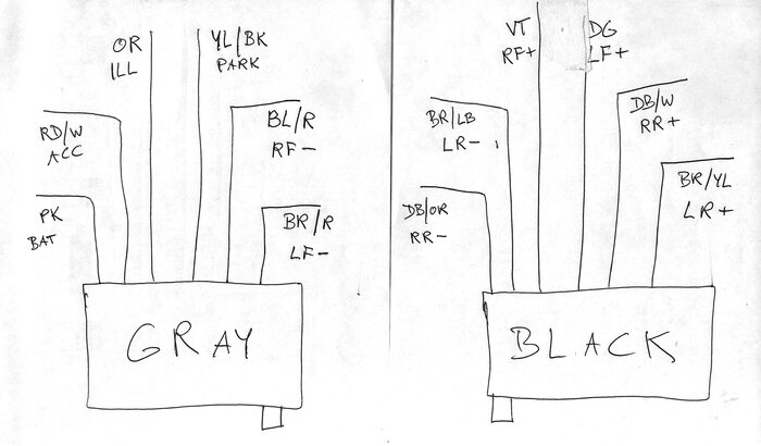

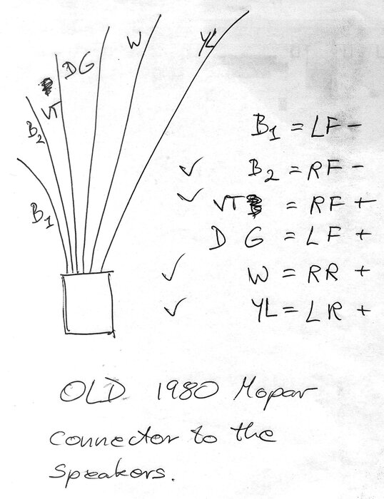

Guys,

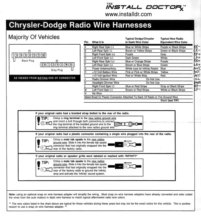

Hopefully this helps out someone...but I had converted the factory wiring harness in my 1980 coupe to the recetangular plug so that I can hook up the Infiniti radio.
Take a look at the attached docs...one is a generic wire/connector plug mapper, the other are hand sketches of how these mapped out to my 1980 specific factory wiring plug (the square one).
MOPAR - Radio Connector Pin Layout - New Black and Gray Connector Mapping to OLD Mopar Connector.jpg
