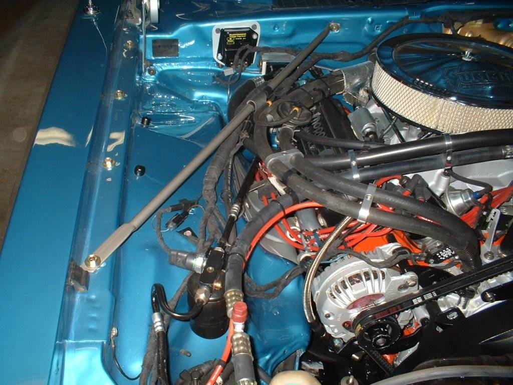

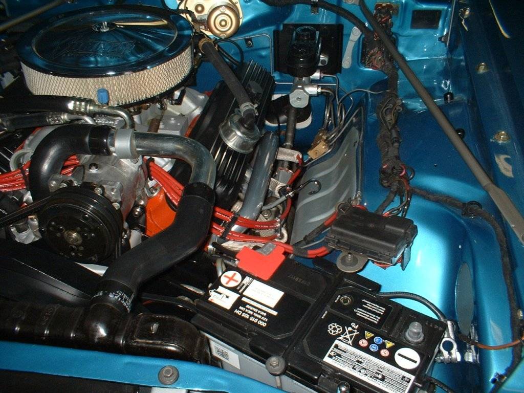

Using their parts (and advice) I hooked up the air on my big block Aspen and it looks like a stock(ish) system. High side lines are originals but the rest is all new.
