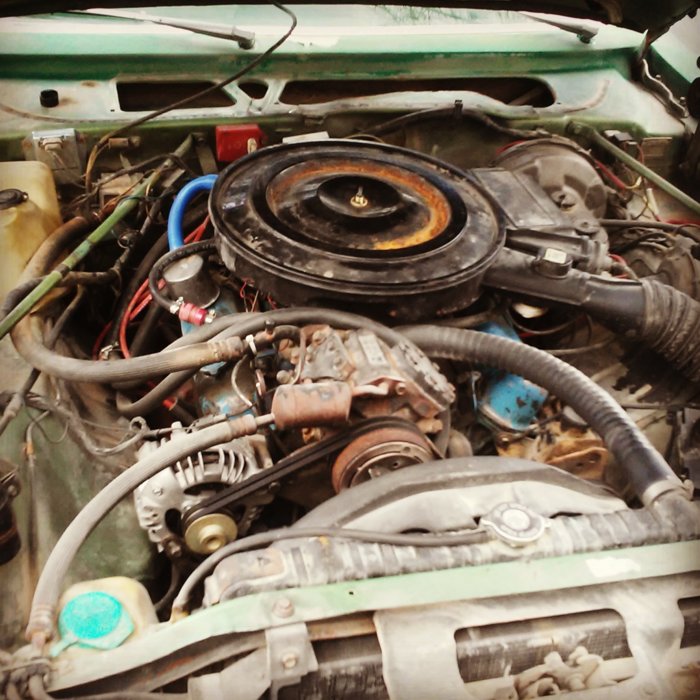

I want to remove the a/c compressor from my 79 Aspen 318 factory air car. I noticed when I tried this, that the a/c and alternator brackets are one in the same. Is there any market for the factory a.c. stuff? Would anyone be interested in swapping my a.c. for your non a.c. parts? This is my daily driver, so I would need your parts first.

It does get hot, but everywhere other than my car has a/c. I'm also not willing to sink the $$$ into restoring the whole system.

Why do you need to do a complete restore on the a/c? Just do whats called a dirty retro,, change the a/c oil to pag oil,,add the 134 fittings and recharge with 80% of the gas and your back cool, We done that for many moons with little to no problems

Needs a new compressor,clutch, lines, condenser, blower motor and of course a receiver dryer. There is no quick repair, 40 years in the desert and the entire system is shot.

This thing is rust free for sure! But every piece of rubber and plastic is basically rotted. The a.c. repair guy showed me the massive leaks at the hoses, and the dirt/scale/rust inside the system. I'm poor, and I live at an apartment that does not allow you to work on your car. It would cost me about $1500 to get it repaired at a shop. That's almost double what I paid for the car.

i just did this when i put in my 360 from 318,your pulley will work, but you need to keep your bigbracket off your ac so you can bolt your alternator back through it to keep your spacing, just take a diegrinder or something and cut the big bracket down to keep it kinda looking stock,or else it will be to tall and doesnt look good, not a big problem to take it off, i took off lines and cooler and everything i could, looks alot better, i cruise with window down, so i dont use ac, isnt that what cruising is all about? hope i could finally help somebody cause i get alot of help here.

I tried this, but my water pump has multiple fins on it, and the belt touches them. I have heard to just grind down the fins on the pump, but I'm not really keen on that. I shoot BudW a pm.
