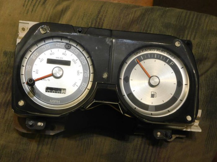

I found another set of gages off e=bay, for the lebaron panel, but I dint realize the OD was digital any one know if it would work with the non digital harness? it is only an 86 MPH gage, but I dont plan on burring the needle too often, LOL thanks

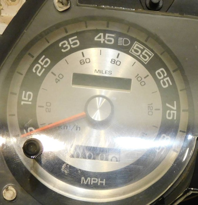

well, heres something new then, it has a digital OD and other than that, it looks like the correct cluster
this was the one that was all rusted out so I cant use it. for comparison
Mikes5thAve
Mar 3, 2020
1,774
730
It is the correct cluster but the digital odometer is completely custom. They never came that way so whatever they did for the harness would have been custom too.

well, in that case, I dont see any differences in the circuit boards so I'm going to assume it is safe to use. if it lights up, or not wont really matter. since it's not the original miles any way. thanks. TAZ

I think I solved the mystery of the digital OD, I was looking at the quad pack of accessory gauges that came with it, and the one that normally says seat belts, say's Air bag.
evidently these are updated gauges, out of a much newer car (mid 80's at least). outwardly they look the same, but the devils in the details.

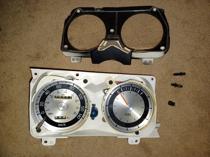

as the picture shows, it has the factory white plastic pins holding it together, so I dont know how it could have been modified? but I'll take more pics for you.,I would not mind figuring out how,if it was,, the junk spedo has a 100MPH face. and cable gear, so I would not mind swapping parts, if I knew how.
Mikes5thAve
Mar 3, 2020
1,774
730
Those 3 black pins sticking out of the front, you can squeeze them with pliers from the back to pull them through to get the face off. Then you end up with this..
The gearing is different in the heads between the different speed models so parts might not be that swappable but at least that gets you apart to see what's going on or to clean stuff up or experiment with it.
You need to twist off the trip meter know too, hold the shaft and just twist the knob backwards.

K now I'm just Pizzed, I was ripped off. I pulled it apart this morning and the speedo/OD guts have been removed, it's not digital, it's just gone. buyer beware. guess I'm still in the market for a speedo/OD.

just wondering about sumtin..how do you change the speedo needle? I noticed yours was broken.I dont see a set screw or pin. thanks.

I think that's how mine might have broke and I'm not sure how sensitive it is to having pressure put on that shaft. It's pretty delicate how it works and probably gets affected pretty easily.

The needle is pressed on. You have to carefully pull it off the pin, and I do mean CAREFULLY.
thanks, the needel has to be removed to swap the face, so I guess I better hope the speedo is still available, mike linked to. when E-bay lets me buy again.
