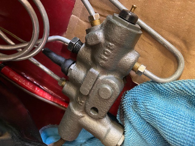

My issue here is I assume the valve is seized or stuck. As I can only get fluid through it on the front side. No fluid to the rear.

The valve, could need re-centered. Try pulling (or is pushing, I forget off hand?) the stem sticking out of the top and then push the brake pedal. Obviously a two person job though. Another way is open a front bleeder screw and jab the pedal a few times. The pressure differential may push the valve back. We run into this all the time on GM trucks when they lose a brake line(s) and you'll get no fluid to the rear. Sometimes it even works by jabbing the pedal sharply. Worth a try anyways before buying a replacement.

Rich, I took it out to get a closer look. I will now put it back in and try what you mentioned. It's like a dance bringing this Long Roof back to life. 1 step forward 3 steps back some days. Grrrrrr!

Might not be the valve but the rear brake hose, I've had it happen on an Aspen wagon.

Thanks although.. Not the hose... As I tested fitting at the back of the P valve to the two rear bleeders. All good there.

Its not a complex valve system, if all fails pull it apart fully and inspect and clean if needed.
