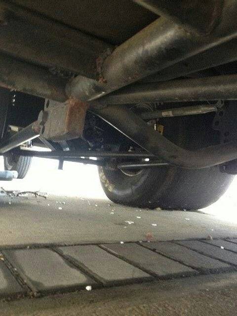

Previous owner back halved this Mirada.
4 link with coil overs and a ford 9" , spool with 4.56 gears and 33X17 slicks on 15" rims..... went hi 8's low 9's consistently.
Car is a rolling chassis, set up for a Mopar BB and is for sale.....
