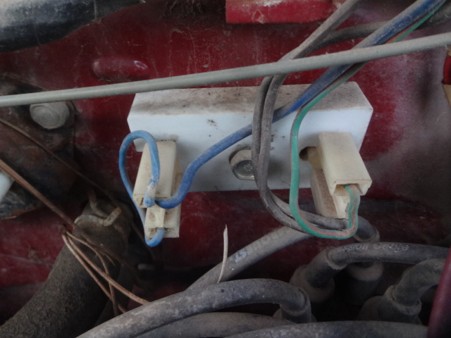

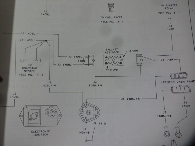

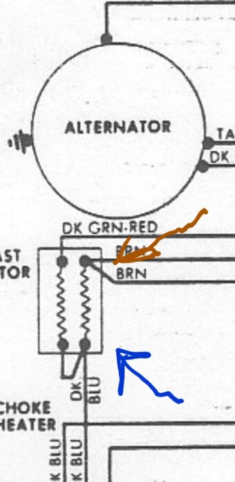

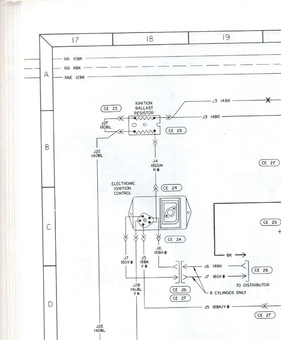

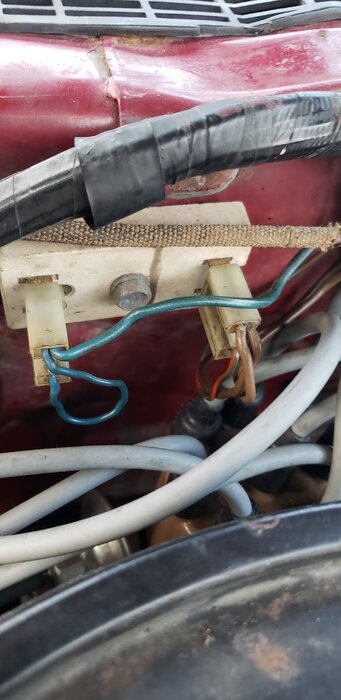

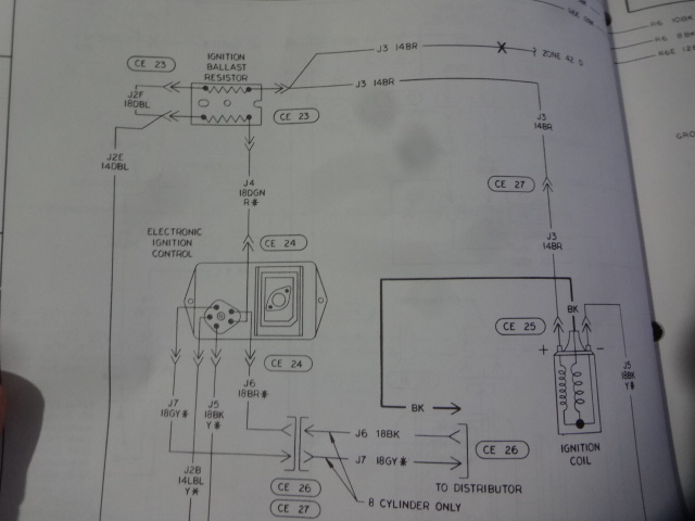

I'm curious to see other vehicles wiring at the ballast resistor. I swapped my blue wires to match the wiring diagram (the picture was taken afterwards). The small blue jumper wire was hooked to the side with the big brown wire. I'm sure it's not a significant difference but I'd be curious how many times it happened on the assembly line.
