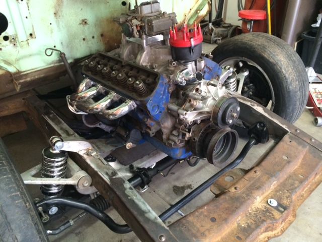

I like the stance on this Imperial. I'm gonna replace the front clip on my Mirada with a strut front end kit from SW and set the engine back 12"

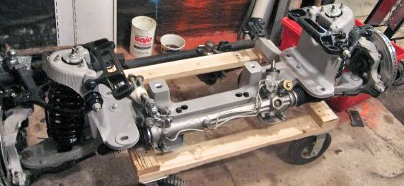

Some are the wrong track width and would require extensive modifications. The '03 and up Crown Vic suspension/steering is excellent but too wide. The aluminum "cradle" would be a heck of a thing to narrow, not to mention the steering linkage.

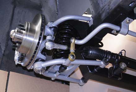

Anything can be done, given enough money (there goes the "budget"), even road racing. Budget is relative, I suppose. The lowest cost for our cars is probably to go through the Firm Feel catalog, and pick and choose the parts that are wanted. I have done this as an exercise, and was looking about about $US1500-2K, in parts alone. Doesn't take into account frame stiffening, which is either a requirement or a really good idea, depending on what level you want to compete in. This is even more important with the $5K alternative suspension, at is will put even more stresses into the frame, just on the baisi of it being able to corner faster.

Replacing the K member front end in our cars, let's say with the Magnum Force (that is in one of the other postings) or Alterkation front ends will improve things. However, it will be $US5K or so. Most of our cars are not worth $5K. So again, I ask what is the point, or more succinctly. why, considering that it works fine (if in good shape) on street driven cars.

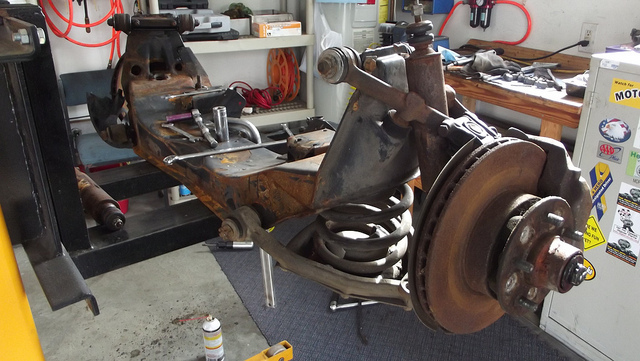

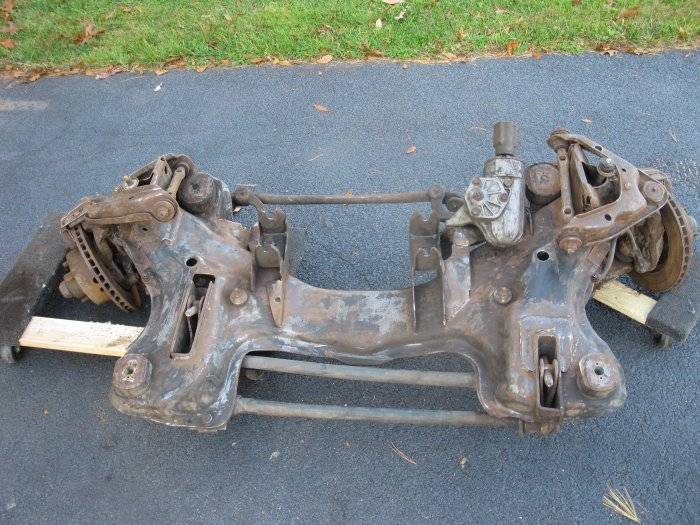

See this jewel. I took it out of my car a few years ago when I started my own project. When I pulled it, I was surprised just how bad the welds were on it. Anyway, after riding around in the Challenger and liking the way it handled, I decided I could do better with the Volare, so that's how I look at it.

Whenever I get my hands on another spare K frame (had multiple opportunities, just timing didn't work) I plan on reinforcing the welds, control arms, putting new poly bushings in everywhere, along with a new borgeson box.
But then again..I need a cash flow well enough to support that.
