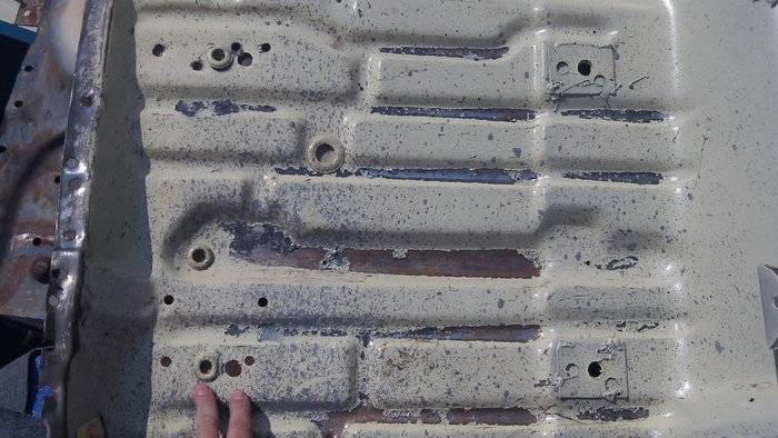

Jim, I haven’t changed seat types on an FMJ (yet).
Did you say the four bolt holes for a bench seat are in a different location than four outer bolt holes for buckets or 60/40 seats?
OY, there is a reinforcement under the floor pan, that inner seat track studs go through/bolt too. If I recall correctly, it actually has 4 stud holes in it. I have a bucket or 60/40 seat reinforcement in my garage – but don’t remember what it looks like exactly (been 10 years sense I stuffed it in to the far corner of garage attic).

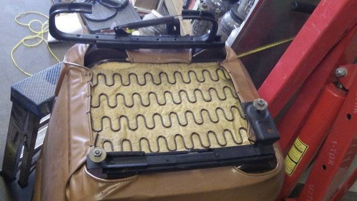

Yes Bud...the bench seat tracks mount further outboard than the outer bucket/60/40's.
heres the ps seat tracks:
and the floor showing bucket holes and bench plugs:
(you can see the bucket/60-40 reinforcement plates on the inner holes)
1,494
Thank you, Jim!
I never had a need to change seat types – so now I know one needs to drill twice as many holes to make ‘em fit.
The reinforcement bar I have mounts under the car – from a ’84 police car – so it might be a police only thing (for police eating too many donuts??).

Thanks Jim, the pics really help. I'm surprised I don't remember more about a swap I did back in the late '80's: I swapped out a '77 Volare wagon bench seat for '79 60/40's out of a Diplomat wagon. I don't remember it being much of a problem. That was a really nice wagon - mint green with green interior and the '60/40's were beige velour. I replaced front and rear seats, and also used the chrome strips and beige carpet in the cargo area. Had the car repainted in the original mint green color and drove it for years! These days, I might need to get the extra "donut" reinforcement bar! :D Also, to DCAspen: sorry for sorta hijacking your thread on your plaid bucket seats. They are a pretty rare item and I hope somebody takes advantage of your offer. ;)
