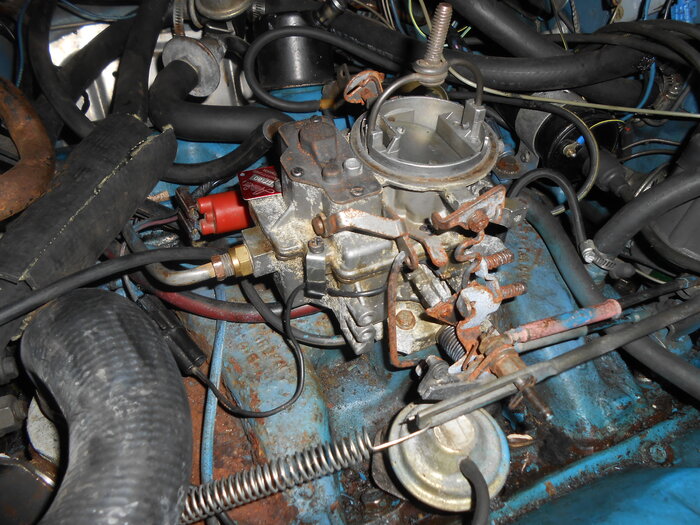

I'm going to be buying a carb and I was wondering how I can tell which brand -Holley or Carter- my car has. Lean burn, but it has been converted to electronic ignition.

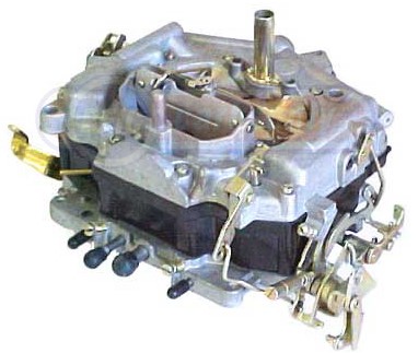

The TQ has an aluminum top and bottom. The middle section is black (plastic). The fuel line attaches to the rear.

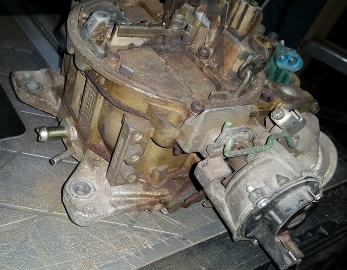

The GM QJ is yellowish and fuel line attaches to the front. It will also have an attached electric choke.

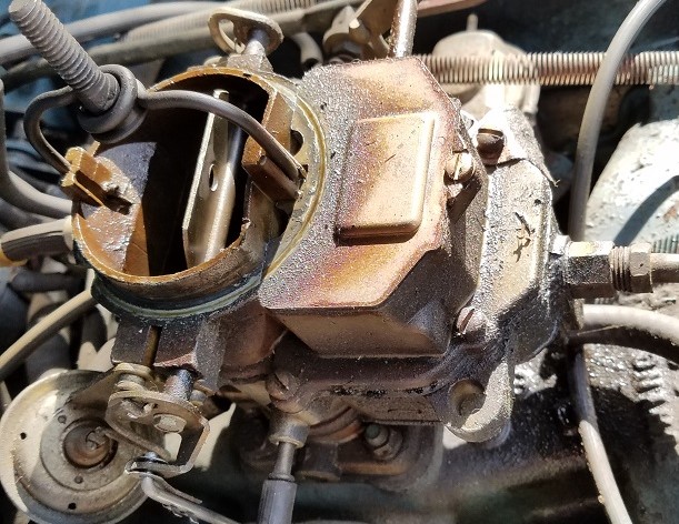

The Carter BBD is aluminum (top, middle & bottom) with a yellow metal top plate (without squared corners) on top that looks like this.

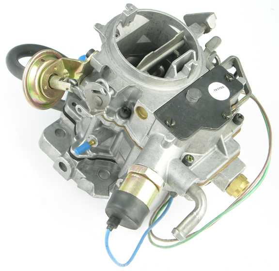

The Holly 2280/6280 is also aluminum (top, middle & bottom) with a (yellow, black or white) metal top plate (with square corners) that looks like this.
At first glance, it is not easy to tell the BBD from the 2280/6280 apart.

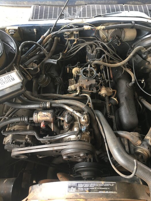

If you still not sure which carburetor you have, then a picture would really help.

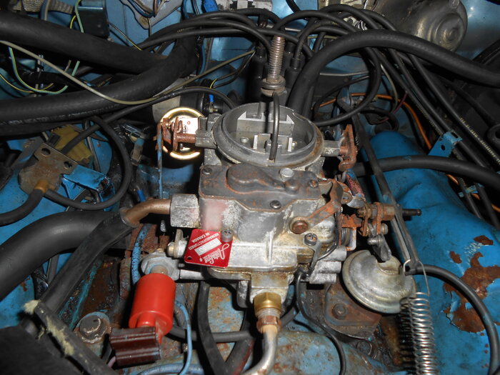

It has a red tag that says "Autoline C-7180 - Remanufactured in Canada", so I'd say it's a replacement.

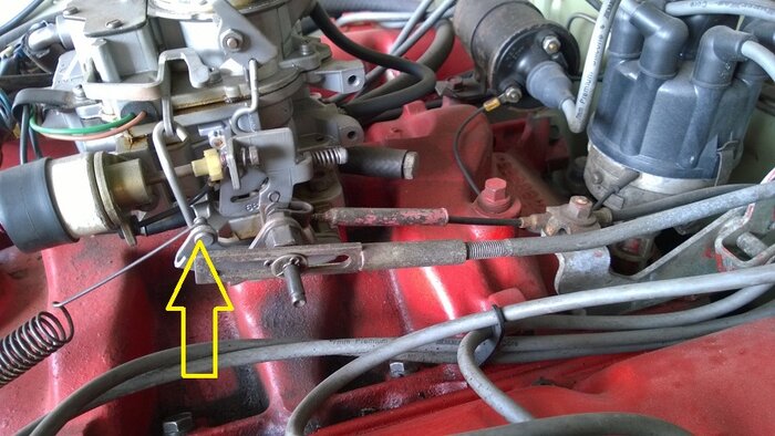

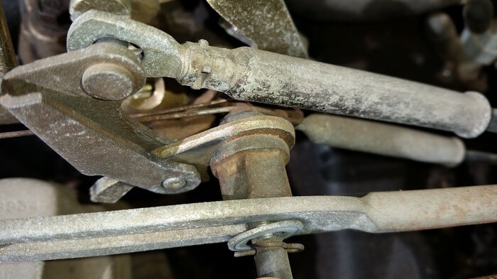

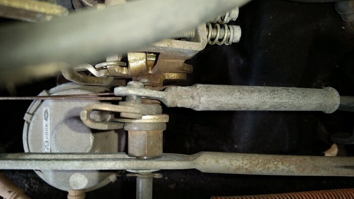

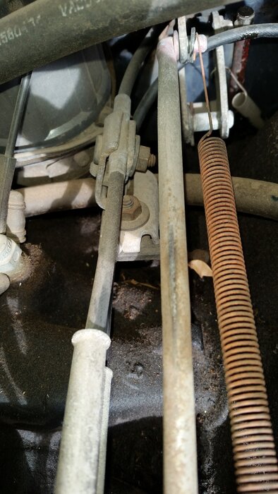

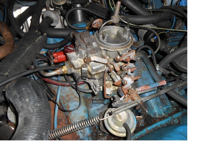

Does anyone know what this part of the linkage this is? It's not connected to anything.
69-
Dec 13, 2020
370
247
Germany
Which one? The long hole? That must be connected to the throttle lever at the automatik Transmission, otherwise you risk frying your trans.
69-
Dec 13, 2020
370
247
Germany
Ah, sorry, I didnt See the little black arrow in your pic.
I would guess that the throttle return spring would fit there? The kickdown lever spring should connect to the other side, by the way.

It’s the lost motion linkage if you had cruise control for the cable to attach to.
1,422
575
It's been a while since i messed with those carbs but a spring is supposed to go from one spot back to the kickdown linkage. The throttle return spring goes to the post that sticks out that goes thru the kick down rod. It's not supposed to hook to the front of it like that. Altho the way the spring is hooked up now is sort of doing both jobs at once.
Deano
Jul 24, 2020
161
26
Clarkson, KY
Okay. I see now. The return spring is supposed to be connected to the linkage I was questioning.
1,422
575
I think it goes further back to the next post and the cruise cable connects to that empty bracket like R.W. Said.

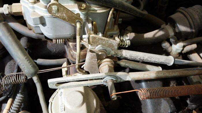

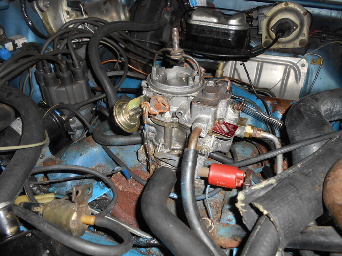

That is a Holley 2280 carburetor – but I DO NOT RECOMMEND getting “rebuilt” carburetors (that comes in a box from a parts store). Do a search using BudW and “rebuilt carburetors” for my list of reasons. Getting a carburetor rebuilt by a carburetor shop or by yourself results in much better results.
The unit you have is for “Lean Burn” but is not computer controlled. Sense there is potentially a thousand different possibility's of having this one messed up by the “rebuilder” and I would assume you are experiencing issues now, I would recommend fining another unit that is NOT REBUILT and comes in a box from a parts store.
I would guess your carburetor is about five years (or newer) and it would have replaced a Carter BBD. The choke thermostat looks original. Even if your vehicle is one of the very few that came with a Holley 2280, the choke thermostat is still past its usability and I would also highly recommend its replacement (if original carburetor is a BBD, then choke rod length is not correct to begin with.

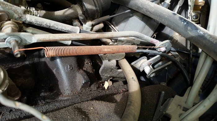

Here is now the throttle and cruise linkage should be hooked up.
This is with (engine off) throttle open.
Note: the above pictures are from my '86 Fifth Ave with a new replacement BBD “Chinese knock-off (gasp)” in place of the Holley 6280 – but the throttle linkage is exactly the same.

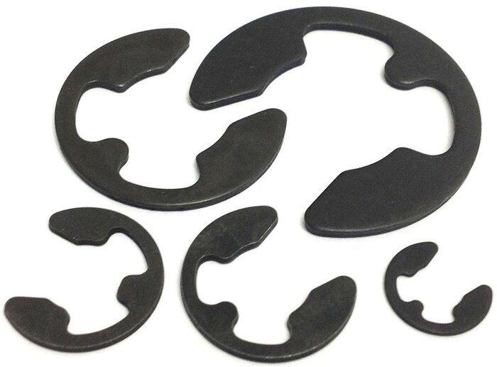

The correct clip to hold the cruise cable in place is a E-clip:
Not sure what size it is. Over the years, I have lost maybe 100 of those E-clips – so watch out
At idle speed and engine warm, the cruise control make up link (the item marked in picture) should have some play (0.010-0.015”) in the link. Otherwise, the cruise can keep the throttle from completely closing – which can make for a “bad day”.
