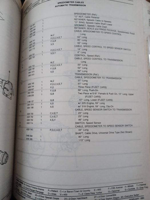

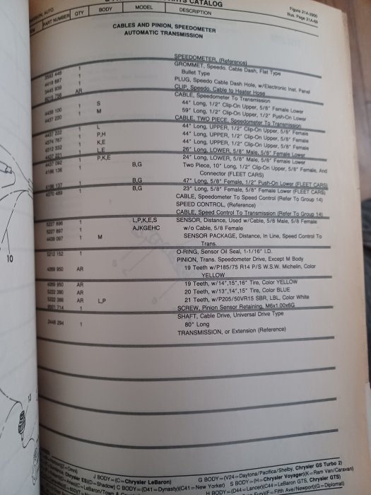

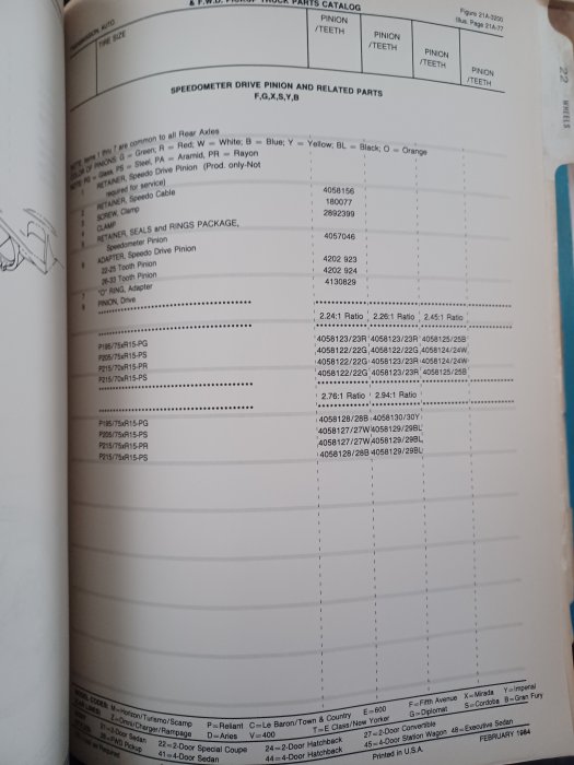

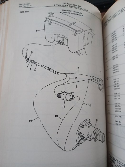

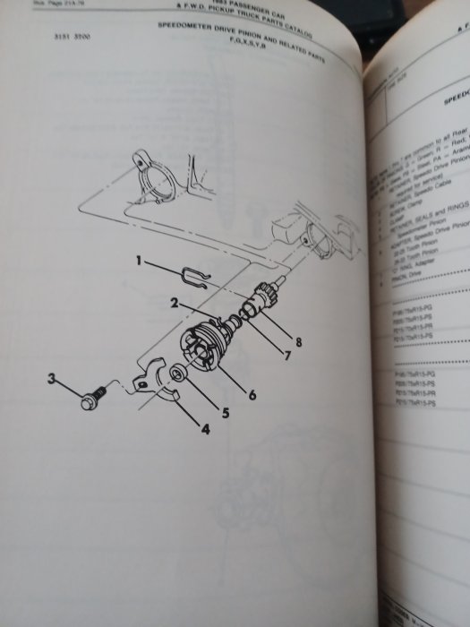

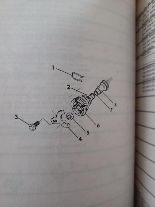

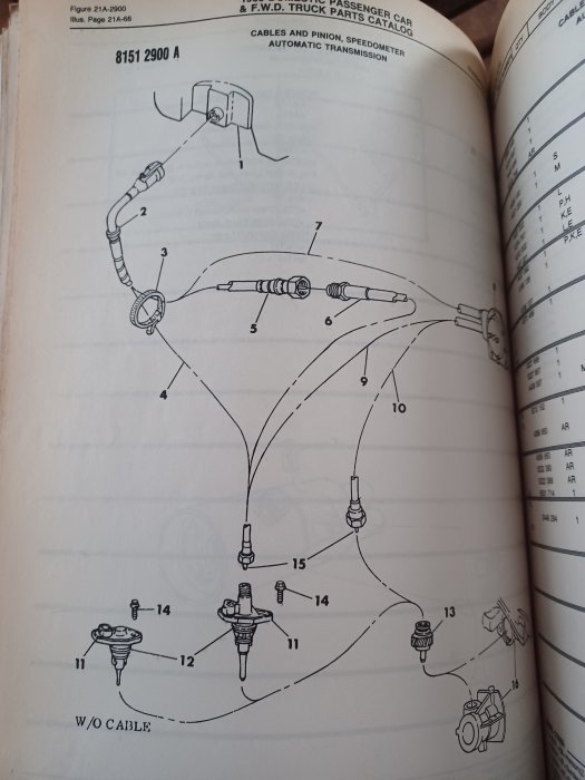

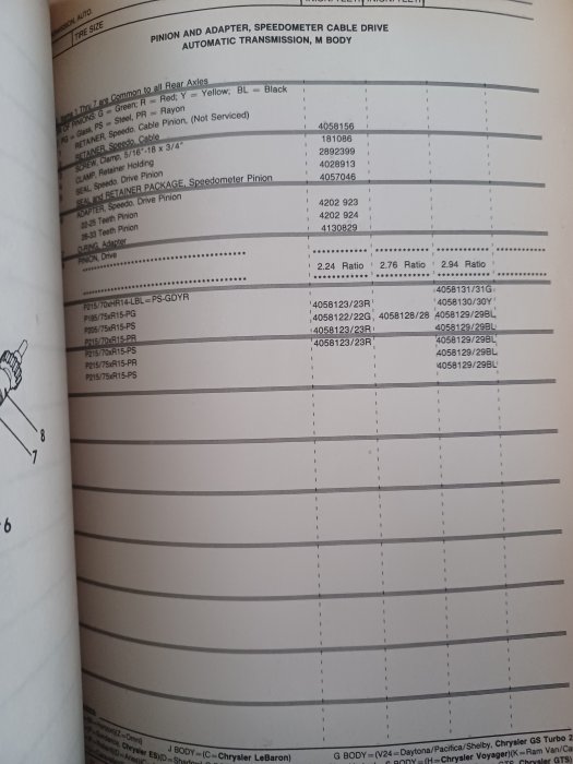

Did the police cars have cruise control? I wonder if that has something to do with it. That and the speedo gears being different. The police car was an 83 and your car is an 88? I bet something is different between them. I have an 83 and an 88 parts book, I'll start digging
AMC Diplomat
Feb 14, 2023
1,118
521
NY
1988:
1983:

Probably a different number of teeth on the speedo gear

This is my thought. Could be the speedo was 10 mph off in the car it came out of. The only thing that would cause it to be off (provided the car has the correct speedi drive pinion) is the speedo itself.
What I mean is, if the 85 speedo was correct, and the 125 isn't, the only thing that changed is the speedo. You could send it in to be recalbrated ($$$), or change the pinion for one with 2 teeth more or less (depending on if the error is faster or slower), which would get it to read closer to actual speed.

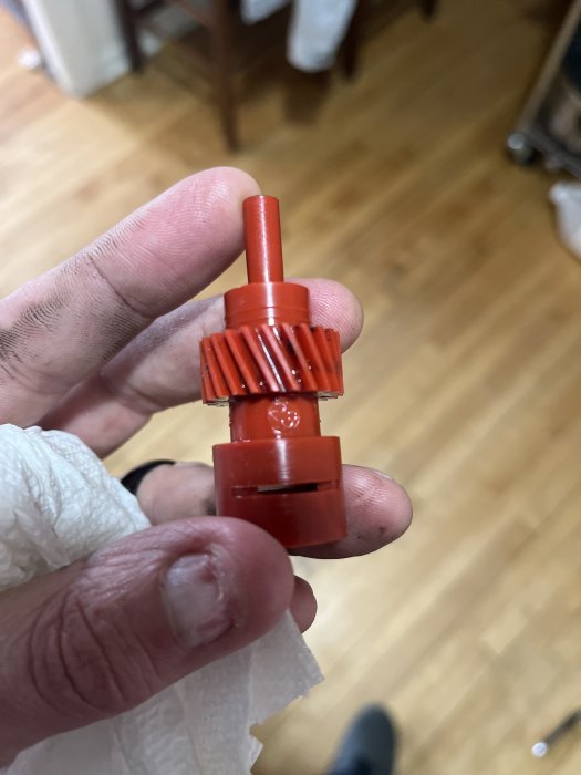

Previous speedogear was a 23 tooth, think it’s a 22 tooth gear in now with the current trans (light translucent blue colored gear). Haven’t really noticed any difference particularly.
