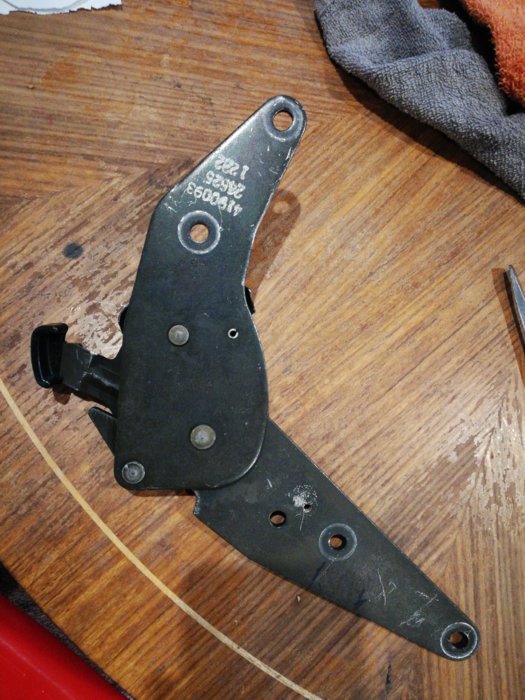

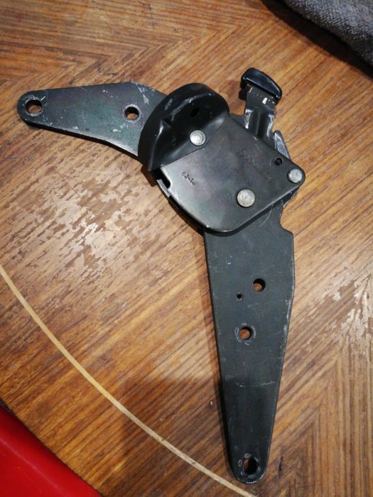

Here are some pics,I bent cover up to see how it works, it's riveted together so will need grinder to get apart.

Pay attention if you pull those apart, I would think they can be repaired it seams at some point have done a pair or two.

Well I see my assumption was wrong.:oops: Your seats are not similar to an F-body bucket. Mine just have shouldered bolts that attach the seat backs to the cushions which also act as the hinge pivot pin.
2,992
That looks about normal, same as the seat in my Aspen and Dakota. "The law" should be satisfied with what you've got. hopefully.
