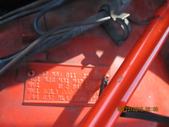

Does anyone have info or a source for decoding a 1977 Broadcast Sheet? I'd like to know a few of the specifics that do not come up on the back side of the Sheet.

Take a picture of the fender tag and/or write down all of the numbers/letters as displayed, and post here.
I have a majority of the codes on hand.
Not aware of a site that has the data published somewhere - like the older Chrysler products have.

Thanks Bud, here's the tag. I've got the tag info decoded, but there are some items on the broadcast sheet that are not on the back index guide.

Your Fender Tag (for what of it I could read):
N37 – Catalytic Exhaust System
N95 – California Emission Controls
R11 – AM Radio
M21 – Drip Trough Moldings
M26 – Wheel Lip Molding (Type 1)
M31 – Belt Moldings – Doors/Quarters (Doors only, in your case)
M43 – Grill Surround Molding
MV1 – Upper body paint code – Spitfire Orange
B4? – I believe this to be a B41 = Power front disk brakes / rear drum brakes
MV1 – Lower body paint code – Spitfire Orange
B2L3 – Bench Seat, Light Parchment (color)
000 – special interior paint (none, in this case)
C26? – December 26 1976 (can’t make out, so might be wrong)
E44 – 318 2-bbl
D32 – A998 Automatic Transmission
N – Aspen
L – Low Price Class
45 2-Row seat, Station Wagon
G – 318 2-bbl
7 - 1977
G – Built in St. Louis

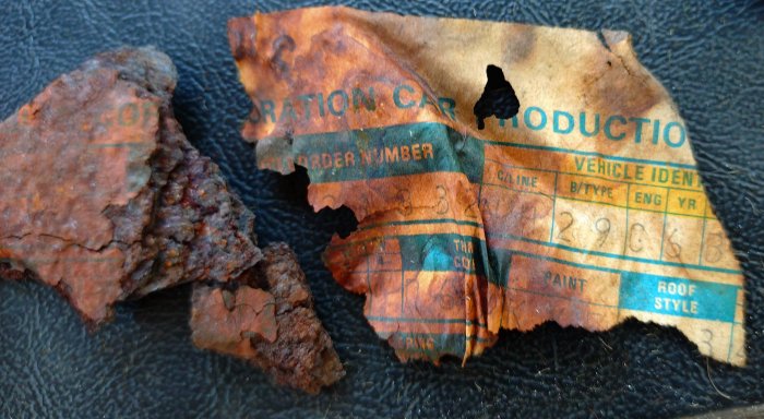

There is a small triangle of a sheet I found under the dash pad on my ’77 Volare wagon. It was taped at an angle and you can tell they ripped the sheet, leaving the tape and remaining triangle when done.
