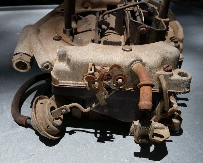

Back to an earlier statement. You will want to test your choke pull-off before ordering one.

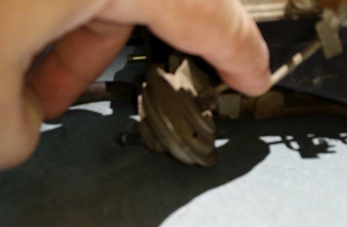

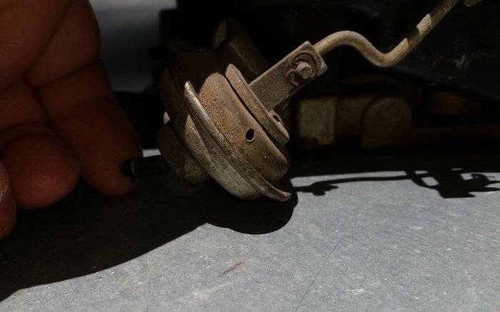

These pictures are from a Thermoquad – so appearance will be different, but procedures will be the same.

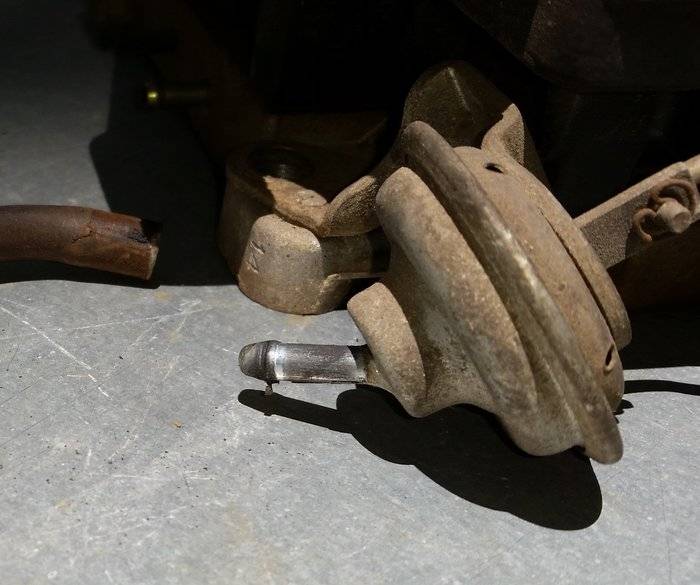

Perform test with engine off.
Choke pull-off will be on passenger side of carburetor.
Find hose and pull it off (temporary).

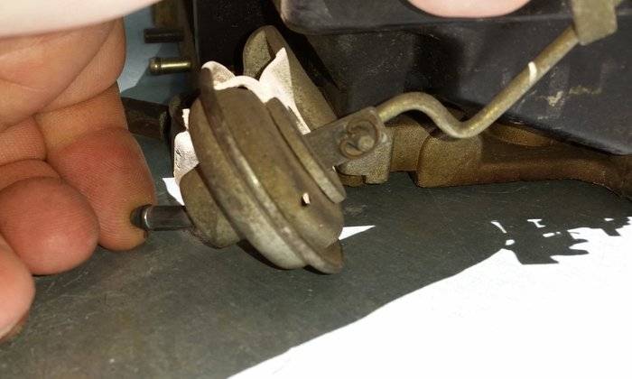

With one finger, push the rod and linkage towards and into the vacuum chamber.
With another finger, plug the vacuum hose nipple (as shown).
Let go of the linkage. It will move slightly but should stay in a down (pushed in) position for some time. Slight leakage is not a problem (but does, indicate a pin hole in diaphragm).
This one is bad, and linkage fully extended in about 4 seconds (with vacuum port plugged).
Note: finger is still plugging the port, but camera didn't take a good enough picture to show it.
If you have access to a hand held vacuum pump – you can use it to test it as well, but the finger test is a lot faster.

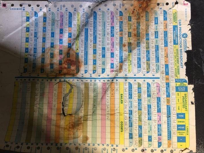

About the historical records: I do have the Production Broadcast. It is still in the trunk glued to the floor in a very fragile state. I can see from the VIN that it was made in Fenton, Missouri in Jan. 1979, but I don´t really know how to decode the whole broadcast sheet.

Great, you have a broadcast sheet!
They quit leaving those in cars in the mid to late ‘70’s – but still used the sheets (they discarded them instead of just leaving them in the cars).
It would be nice to get this sheet scanned at a high pixel rate, so one could read it better, when blown up.

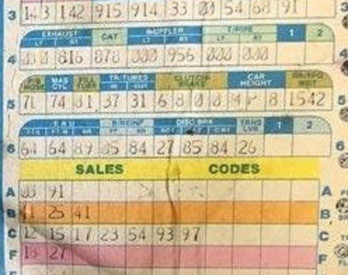

Most of it makes sense to me – other than I just can’t read yours.
I blew up a portion of the sheet that I could read:
Line 4
Exhaust LT (not legible). Rt 816
Cat 878
Muffler LT 000, Rt 956
T/Pipe Lt 000, Rt 000
Line 5
P/B hose (power brake) 71
Mas Cyl 74
(Can’t read) 81
(Can’t read) in 37, out 31
Clutch/Brake 68 00
Car Height (can’t read first two positions) 8
(Can’t read) 15 42
Line 6 (can’t read)
Sales Codes
A 03 91 (which translates to Sales Code A03 and A91, and so forth
These sales codes may be on fender trim tag – but not necessarily.
The digits on sheet, just below the description, are the last two (or three) digits of the part number.

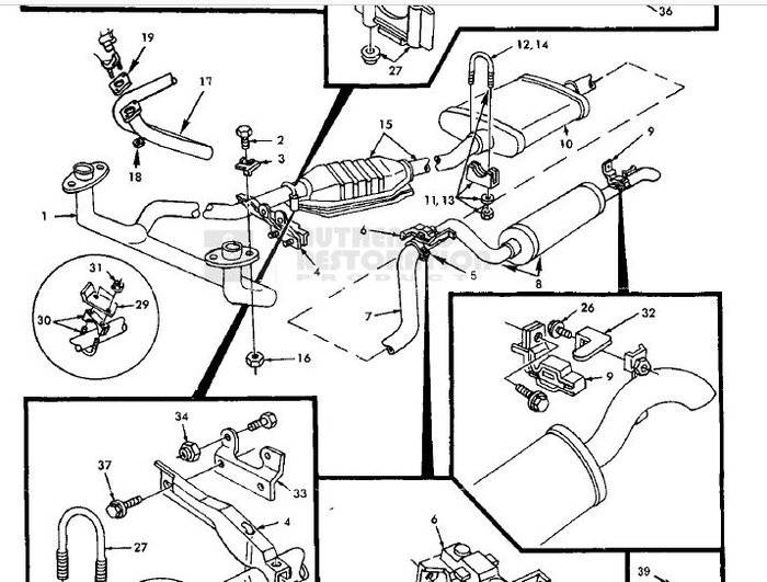

Now with that said, many items come from venders pre-assembled, for example the muffler. Tailpipe and resonator (if equipped) comes as one huge assembly. The brake booster and master cylinder also come as one assembly. The brake (and clutch) petals with pads come as one assembly – so the part numbers on those DO NOT directly correlate to the parts manual.

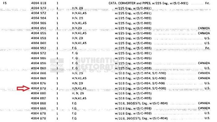

Some things do directly correlate with the parts manual – like catalytic converter for example.
If you notice the Catalytic converter from the part manual page, mentions sales code N94 (US 49 state Lean Burn) – which is also mentioned in the Sales Code “N” section (as 94}.

That is impressive how much you can tell from this sheet ! I would like to get it out of the car, but I am afraid it will break.
Is there any way of telling from the sheet to which dealer the car was meant to be shipped from the factory ? It would be fun to have as much history about it as possible. It was auctioned by a classic car dealer in Boise, Idaho, and the description says it was previously driven in Washington/Idaho by two owners.
Maybe – but I doubt it.
The Build Sheet is mainly the “shopping list” for the assembly of the car, and not really meant for anything else.
I have seen and touched hundreds of Build Sheets – but this is the first one I recall seeing for a ’79.
I agree, they do get brittle – and that fact is only going to get worse as it ages, not better.
My recommendation is to get a plastic sleeve for the page to place it in. Maybe even sandwich it between a pair of clear plastic plates? (so it can’t flex).
Just make sure the storage location is not where the sun doesn’t normally see it (sun will fade it completely out, over time).
Maybe F Body Deconstructor Jim has been keeping Build Sheets from (or for?) his collection. Now, I’m curious as to how many he finds?
Most of the ones I seen, was when I worked for Chrysler years back – and they just got in the way. I have kept a few of them over the years and gave to next owner of the car – but never took time to go looking for one.
My ’77 wagon has a 3” (7cm) triangle of a sheet taped to the black instrument cluster frame – that appears the rest was ripped off, during assembly. There might be others in the car – but not taken anything apart to find out (and don’t plan to for a long time) – but I doubt it.
The cars made from around ‘73’ish and down, you could find a bunch of the sheets in a car, sometimes, in various locations.
I “think” the assembly workers were instructed to toss sheets one done – but IDK. Might have to find a Chrysler assembly plant worker and find out.
