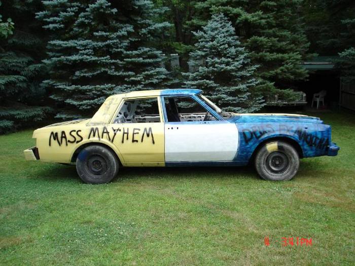

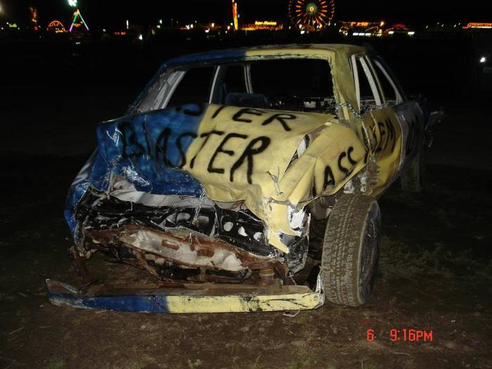

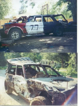

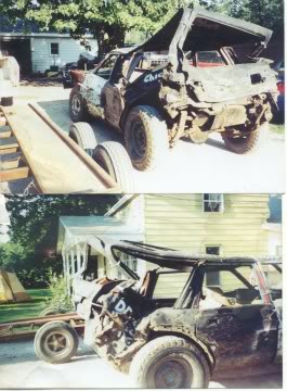

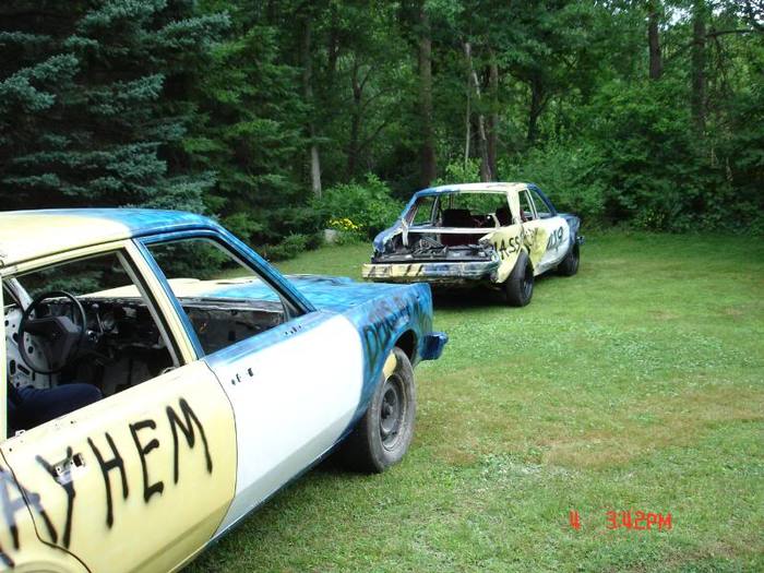

A few of my derby M-bodies. I've derbied four Fifth Avenue/New Yorkers and won 5 trophies with them.
1984 Fifth Ave (before)
84 Fifth Ave and 81 New Yorker

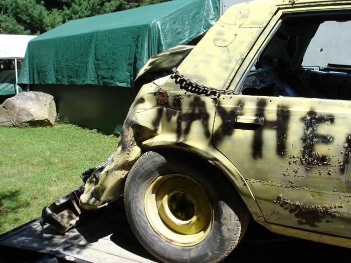

84 Fifth Ave (after). Got 1st!
81 New Yorker. Got 2nd Twice.
87 Fifth Ave (before)
87 Fifth Ave (after). No more trips to the grocery store. Got 2nd.
Anyone else ever derby an M?

Tell your buddy next time he derbys 1 to flip an remount the back bumper . The rearend won't go down .
I know that trick. I was told flipping the shocks and bolting them to the trunk floor would help as well. Most of the derbies I do however are strict and don't allow those kinds of mods. One year I did get away with it though. My 81 New Yorker in the second pic has an upside down front bumper on the rear.

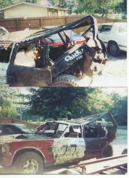

1 of these days my buddy who runs these car is suppose to upload a video of him running against some pretty ( they thought ) tough stuff . Full sized GM & Ford iron . In the video he puts a hit on my son with his "M" body . My son was running a 71 Pontiac Grand Prix , maybe a 70 , been awhile back . Anywho , he took my son out with 1 hit . Shoved the back seat area of the grand prix up to the back of the front seat . The "M" motored away nearly unscaved . Meaning damage to the "M" was very little/minor . We laughed our butts off, and the son vowed not to get into the same heat as " Hemi " again . It was hilarious .
