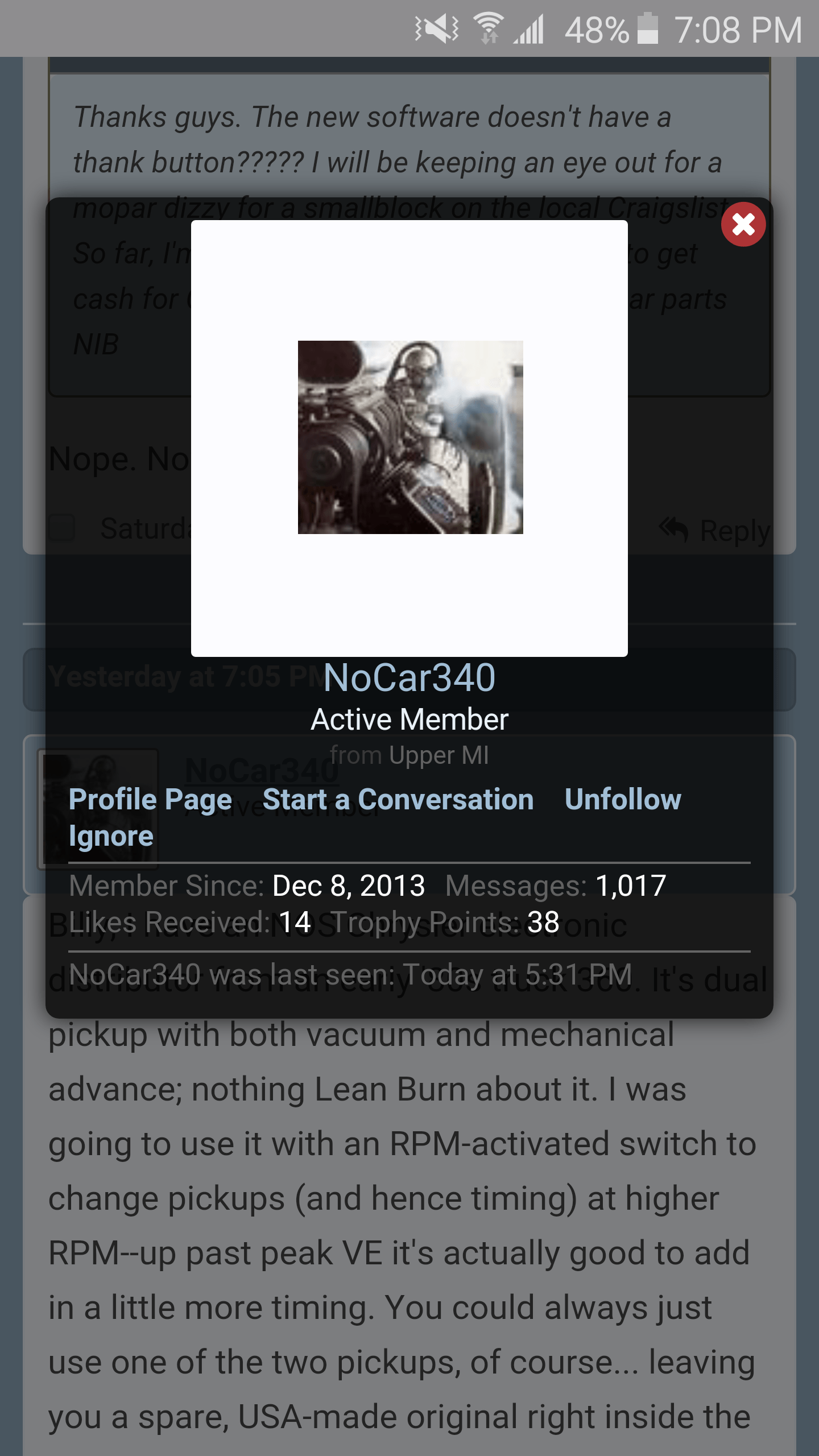

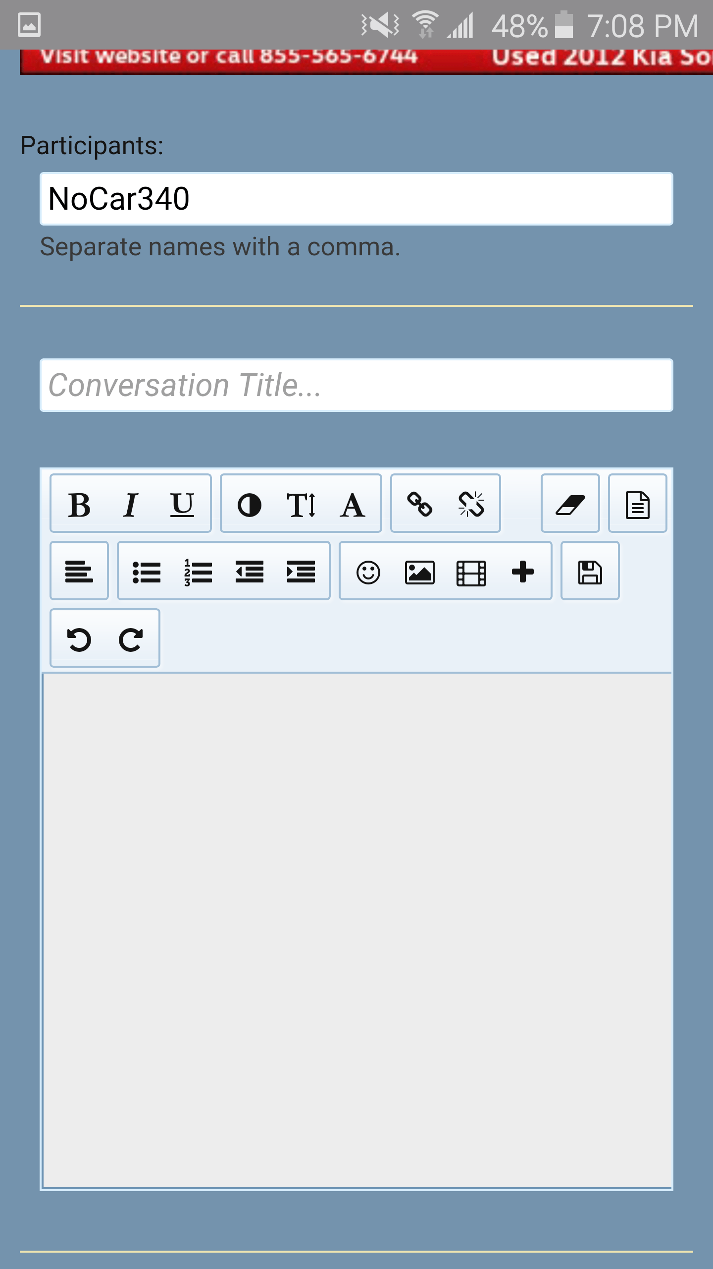

Tried to send you a message, but my inbox won't let me start a conversation.
Tried it and it is just a white screen
Hmmm.....
You should get this.
Then this.
What are you using?
Phone? Computer?
