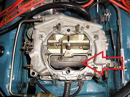

If the air cleaner was off, after choke reset and the cold engine is off, you should be able to push the choke plate (the top moving plate) open to look inside of it, but it will pop closed right back.
Red arrow.
Once engine is started, the choke plate may be still in a closed position, but generally is in a mid-position (not open fully but not closed) and will slowly open fully as engine warms.

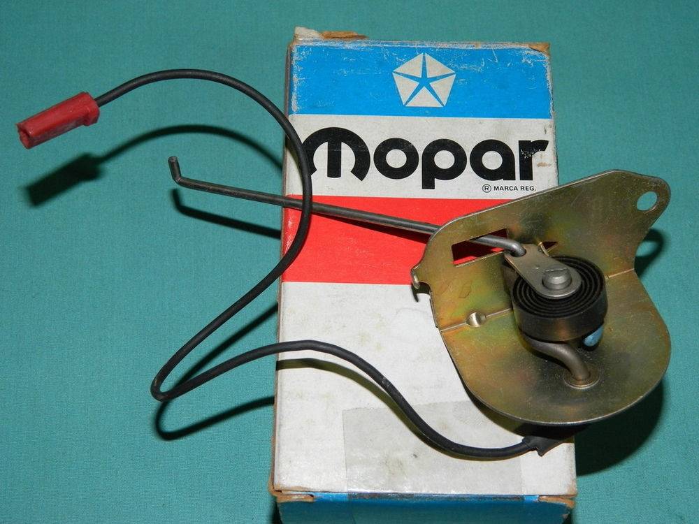

It has been my experience, as the choke thermostat coil (the bi-metallic spring) gets older (10-15 years old), it doesn’t move as much as it once did (kinda falls into, and is stuck, in a mid-position). Generally 85% of the time, replacing the Choke thermostat coil (or assembly) will fix most drivability problems.

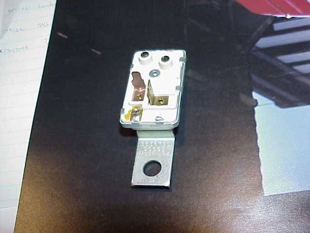

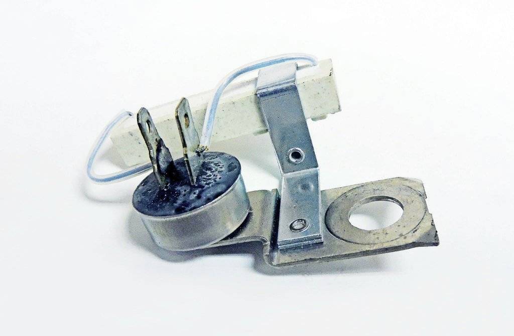

On that year, there should be a choke heater wire coming from the choke thermostat going to a white 1 inch x 2 inch electric relay (about mid position between choke thermostat and distributor). If that wire is broken off or is not plugged into that white box – that could also be a problem. The white box needs to be plugged in (goes to ignition coil, indirectly, I think).
Often, I find a broken wires) or that white box simply not plugged in.
Note: a few cars have a small round black disk, instead of a flat white box with two plugins on it.
Also make sure that white box/black disk is getting power when engine is on.
