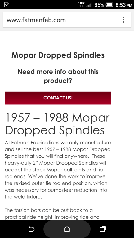

Have a look here
and
We have got some of the most amazing drives in the world over here! But you better have you whits about you thats for sure!
Firm Feel has never carried them (that I know of).
There are company’s out there who specialize in drop spindles (or raised spindles for pickups and vans) – but they generally are not forged or heat treated and therefore what I call “soft”.
Useable - but can bend or snap off a lot easier than OEM parts will.
