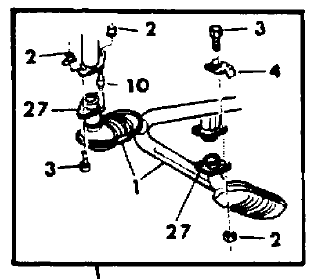

The FSM shows one as a stud, from the illustration, looks like it might be screwed in to the top of the bottom flange, then the top flange is connected by a nut.. I am hoping to not have to drill out a broken off stub in the flanges. I guess I will be at this Monday and look carefully at how the pipes are attached to the manifold. As I remember there is space to cut the bolts, if you can get cutting devices in there. That is if I can even get close to look... I appreciate all the responses.

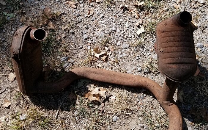

I have removed two Y-pipes in the last decade. One was an Y-pipe from a '80 Aspen wagon (with single rear cat). Those manifold to pipe fasteners were rusty and stripped without much effort.
I finally had to break out the Sawzall and still did some damage:
No, this cat free Y-pipe is not for sale. It is going into my '86 Fifth Ave.
I also had a Dremel with a rotary cutting blade to use.
Deepwell 6 point socket and some extensions and a wobble. Break them off, it's easy.
He was talking about tightening them to break 'em off. I guess a couple of additional words would have helped. Some times this works, sometimes it doesn't.
The Y-pipe I removed before that was from an '84 Gran Fury police car. I removed the engine/transmission/K-frame/suspension as one assembly from the car. Even with the engine removed from car (and from K-frame, at this point), I still couldn't remove the rusty fasteners (they had also rounded off). I wanted to save the flanges, so I ended up cutting the Y-pipe off above the cats, then cut the fasteners off (also using a Sawzall).
I used the flanges on a Y-pipe I had made up at a local muffler shop (and sense sold to @XfbodyX).

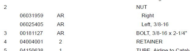

The only studs used is between exhaust manifold and cylinder head.
This is from my '87 parts manual:
The bolts are nothing special.
One side nut has a built on bracket on it to keep it from spinning (much). The retainer is used to keep the bolt from spinning (much).
Dorman made a Magnum exhaust bolt kit that came with 4 nuts, 4 bolts (both were gold colored grade-8 fasteners) and 4 gold colored retainers. The fasteners are common hardware store items. The retainers are what you need to get your hands on. I think the Dorman kits have been discontinued (maybe, not looked).
I know someone makes the retainers.
The retainer will work for either bolts or nuts.
I found the 6031959 p/n on eBay but, gasp, they want a lot!

The fact of the retainers on the top of the flanges, means I have to unbolt that side from the bottom? The item I was referring to was #10. I don't have an 87 parts manual, the 83 manual refers to this part as Stud, shoulder. I have shot Blaster on all the components as best I could, twice several days ago. I don't know if that will help. Probably do it again and let it drip off again tomorrow. I was thinking about stainless steel bolts and nuts to prevent rust. I hope I don't have to do this again...

Sure enough there is a stud there. Sorry, I missed it.
