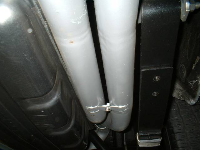

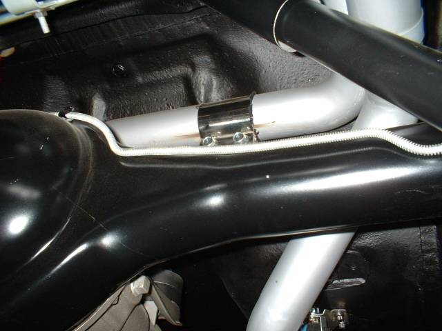

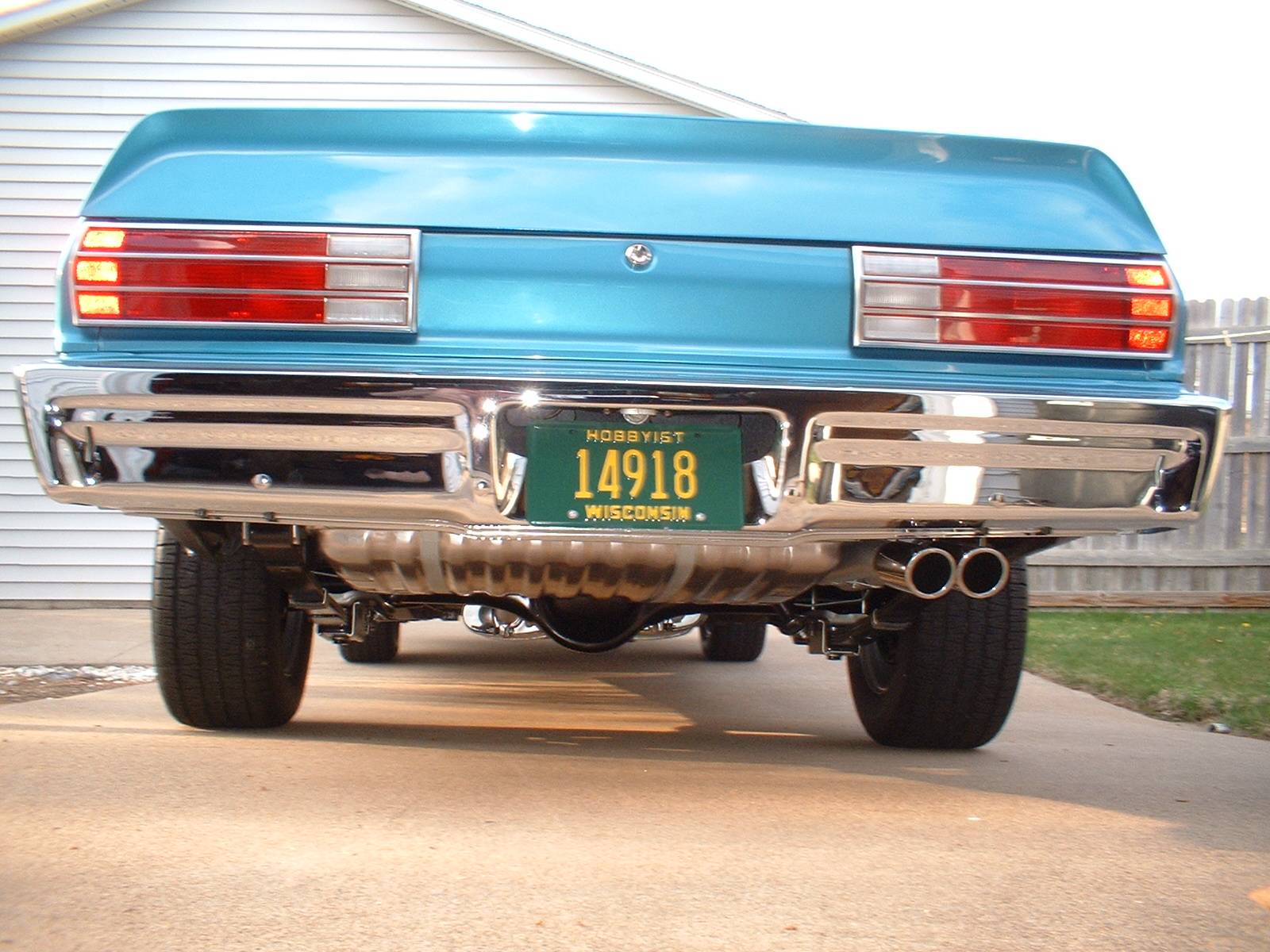

You can run both pipes out the right side and leave the fuel tank in place. The left side has to cross over above the axle and then run along side the right side pipe. There's JUST enough space for 2 1/2"pipes.

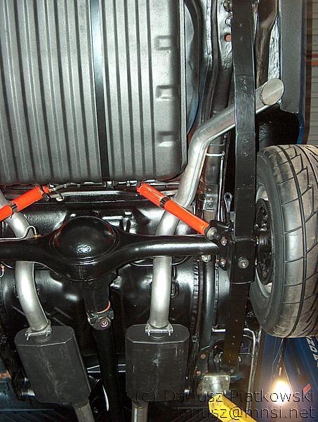

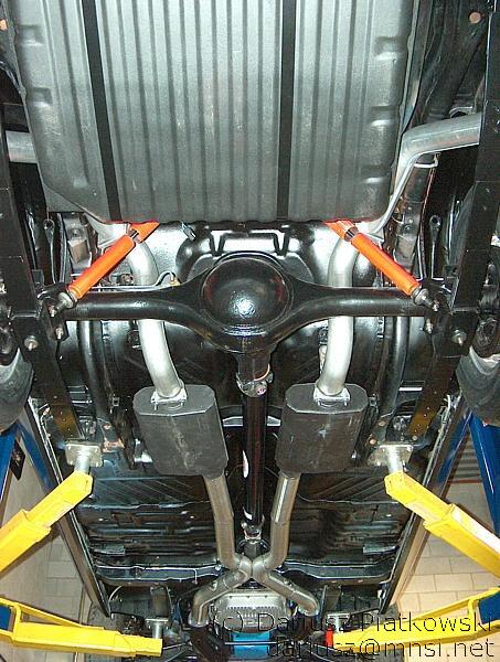

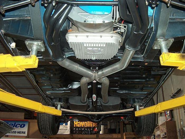

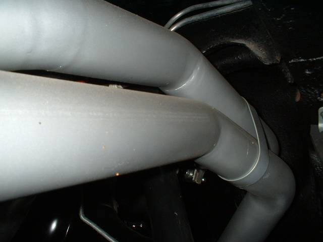

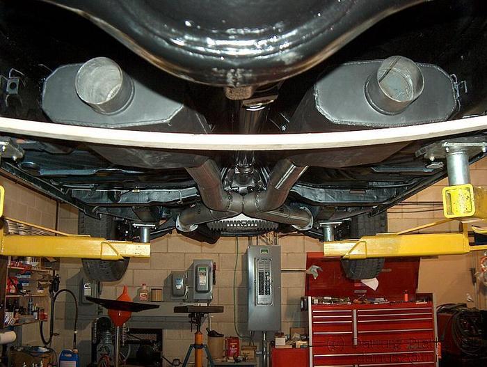

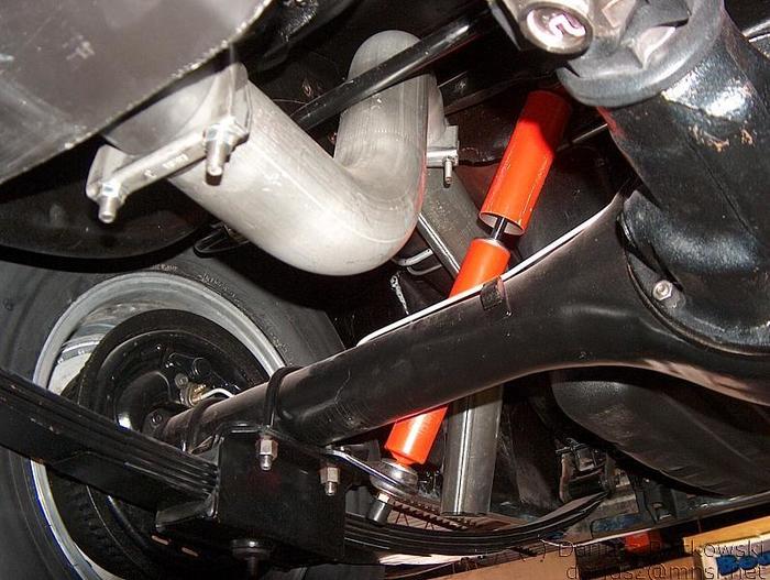

Aspen500: holy smokes...that thing is pristine...excellent!!!

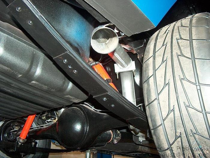

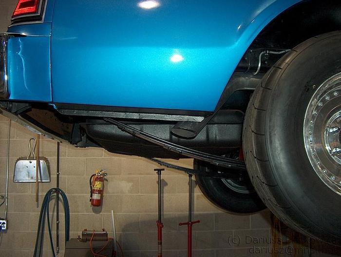

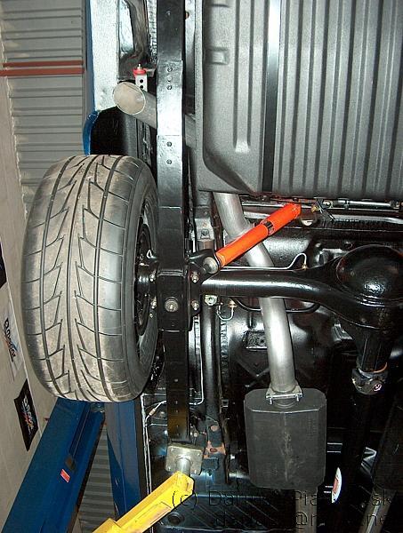

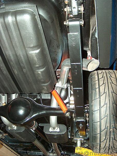

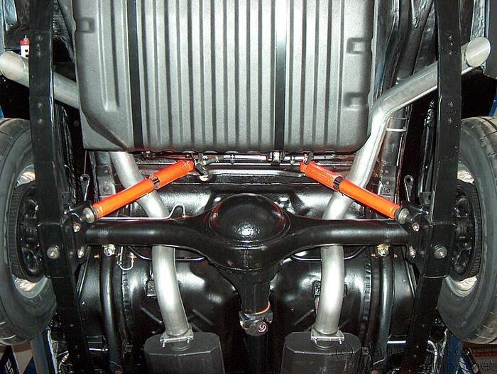

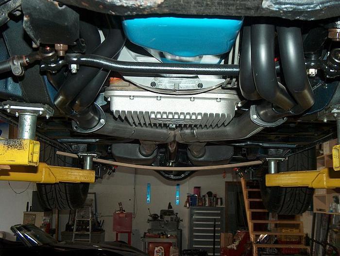

Mopar_Gods: here is what I've done on my coupe...as NoCar340 mentioned, I went the side pipe behind the wheels exit route...pretty darn happy with it actually...cleaned up the back, no issues with room and that is with a full size 3" diameter X-pipe.
So here comes the "exhaust thread with pics" from my Dippy posting days:
There is more to it, but that about does a pretty good highlight of the install.

Dang fellas you guys got some seriously clean under carriages, nice work, great cars..
Now that is one clean and mean looking underside there. Nice work !

Aspen500's exhaust is closest to the stock "dual" setup that Chrysler used under FM&J bodies, until early in the 1980 production year. They used a rear "y" pipe that ran out the back. I think their is a picture on here somewhere.

That's kind of what I modeled my exhaust on. The tail pipes anyways.
Had duals on the '78 Cordoba (360) that I owned from '88 to '96. Did the same thing, ran both pipes out the right side. Like F-M-J cars, the fuel tank was tight to the leaf spring on the left side.
An exhaust shop bent the Cordoba system. The Aspen is the measure, angle find, cut, weld, grind, finish, do it yourself type made from aluminized straight stock and mandrel bent aluminized "U" bends from Summit.
