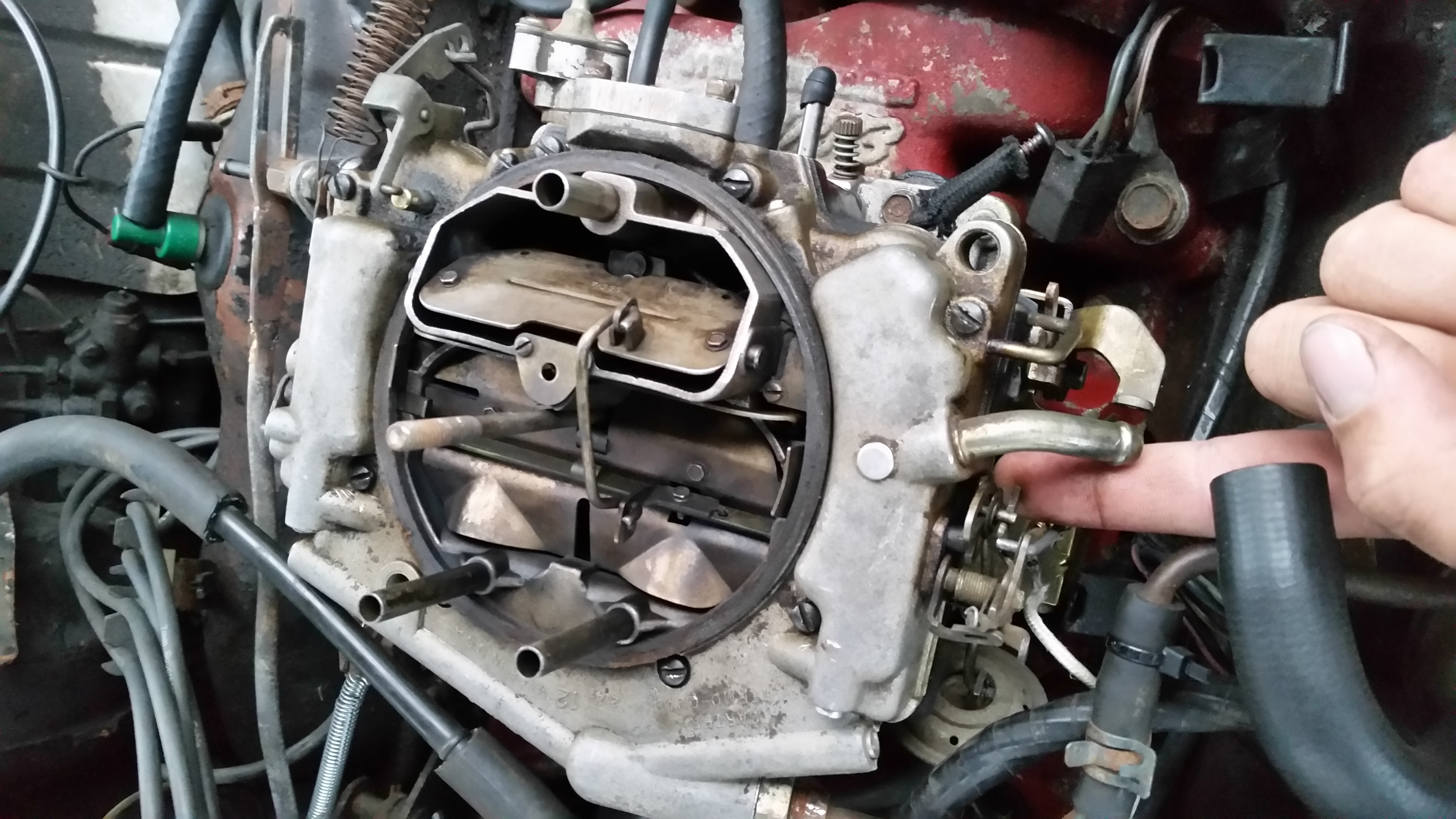

Today I tried something different again. I started it via the remote (28-30f out) and worked the throttle choke manually under the hood.
2 pump shots, the choke closed as it should. I pushed the start button and the engine fired off instantly. It started to do its stumble, but I pushed the choke wide open and the idle picked up to a perfect clean high idle. Running a completely cold engine with no choke and high idling beautifully.
This seems to be about the amount of pull-off the choke can has, does it look somewhat alright?

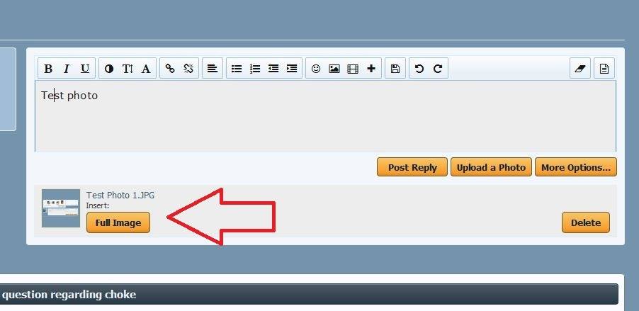

Note: after you "Upload a Photo", click on it (lower part of post) to "full size" 0 but after you click in post where you want said picture at. Hopefully that makes sense.

Note: If I had pressed the "Full Image" button then, then the picture would go where the curser is at (in this case would have placed picture after "Te” of Test but before “st” of Test).

I don't know what is going on with this choke though, quite odd. Wherever the car warms up is a nice black puff spot on the drive-way too. Obviously too much choke or something. Pretty sure every choke i've ever seen operate slams the choke plate completely closed when you pump the pedal. Then the pull-off opens it a bit when the engine has started making vacuum.
Some cars need to be pumped twice.

Fired it up tonight after sitting since Sunday morning. I changed the choke closed position to have the choke plate more closed at full cold, and upped the high idle screw a few turns. Gave it a couple pumps, didn't she fire off on the second crank and run pretty damn well? HOWEVER! The choke is now too far closed to run properly. It immediately starts running super PIG RICH, and bellowing clouds of black smoke. The idle will clean right up and it will purr perfectly if I manually hold the choke plate wide open (even on a freshly cold started engine). The only problem is, the pull-off is pulling off it's maximum amount but it is not enough action at the choke plate. As in, fully pulled off the choke is still far too closed.
Pull-off seems weak anyway, so I will be looking to get a replacement within the next few days.
Sounds like a good time to remove the TQ and perform a bench adjustment to it – making sure all of the adjustments are spot on, before it goes back on. Changing the choke pulloff might also be a good idea.
Making those adjustments are a royal pain to do and time consuming – but well worth it.
It normally takes me about 1½ to 2 hours to get all of the TQ’s adjustments correct – and rarely are they correct – especially rebuilt and just out of a parts store box ones.
I would not let my enemy purchase a rebuilt (from parts store) TQ – for they swap parts from just about anything – including fridge parts and/or from kids toys – and man do those require a lot of work to get working correctly - sometimes requiring parts from multiple carburetors.
