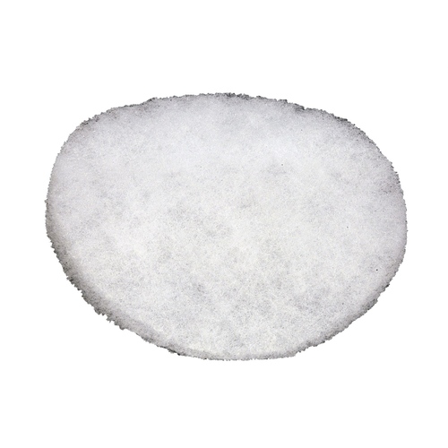

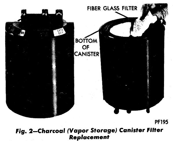

What I recommend to do is to locate and disconnect the large hose that goes towards rear of car from the charcoal canister – and then fill the fuel tank. If tank fills better, then the filter on bottom of charcoal canister is dirty (or canister is stopped up). In many cases, the filter can be removed from charcoal canister and cleaned or replaced – but that is not the case on all charcoal canisters.

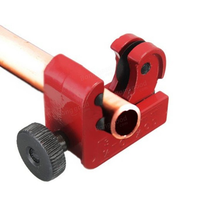

A rusty line repair can be done on car – but you will need to pull line out of the way some, get a pipe cutter and cut a decent section of line out and replace with a section of rubber fuel hose. This size pipe cutter works great on-car.
