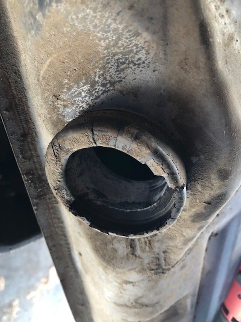

Hey all,

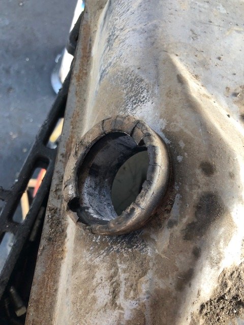

I recently dropped my gas tank down to drain/clean all the crud out of it and replace the sending unit.I tried my local parts stores and online as well for a new fuel filler neck grommet.The current one is old and cracked figured might as well replaced it and a new sending unit since it was bad.Anyone have a source for them? Or just have to measure and cut and try to make something work?I attached a few pics of it off of my 88 dippy.Any help appreciated thanks!

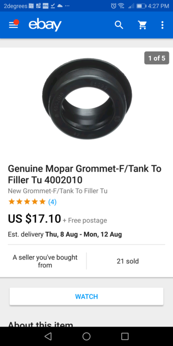

4002010 dodge dealer or ebay or Vans auto The dealer should still have the o ring also.

Thanks guys,
typed in that part number and ordered one off ebay,it'll be here in a few days.

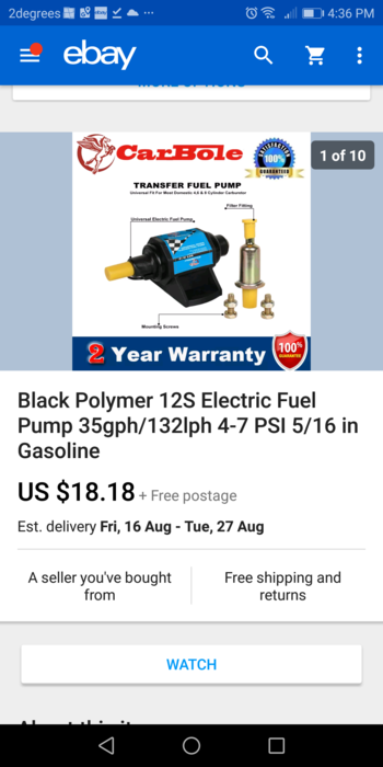

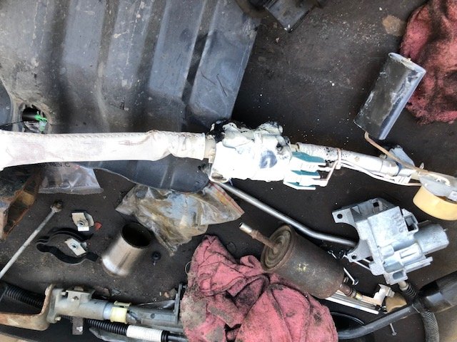

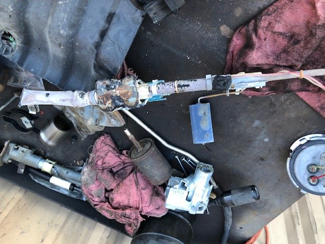

****by the way I found something odd when I took out my sending unit.Did any of the late M bodies have a electric fuel pump at the end of the pickup? I thought maybe it was a special order option since it is a AHB car?
Sorry for the not so great pics and extra stuff on the table.

So i took the dodge part number and ordered one online.Decent quality rubber and was exactly what I needed went right in.Thanks all.

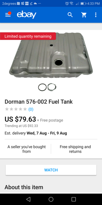

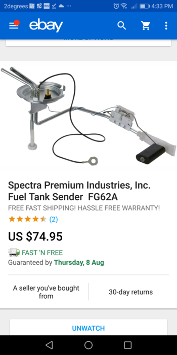

I have no idea what 577-501 fits. You probably needed 577-500. Either way you are better off with the mopar one.
