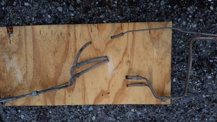

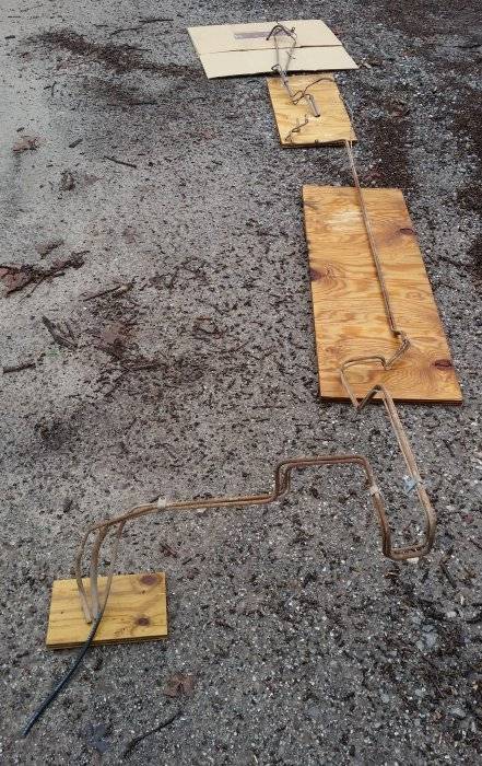

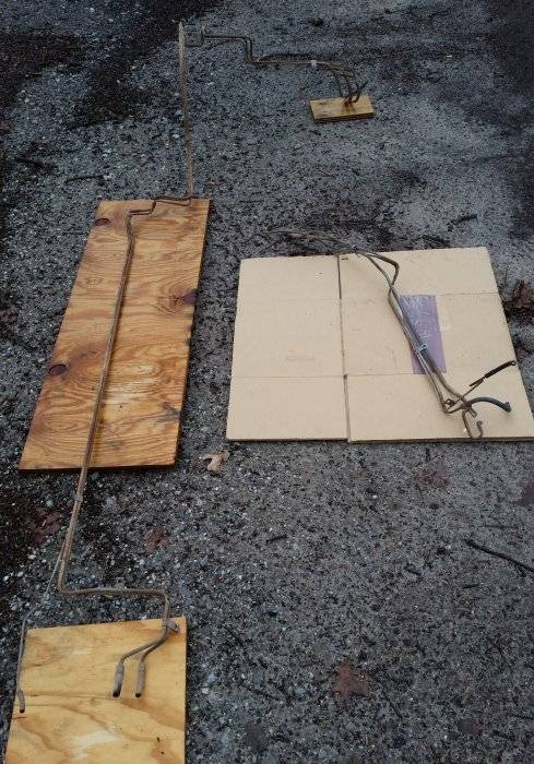

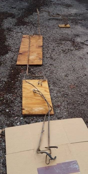

These pictures of the 3 fuel lines off of a ’84 Gran Fury (police).
5/16” main fuel line
¼” return fuel line
(Not sure – 3/8” maybe) fuel vapor line – going to charcoal canister.
The "hidden" fuel hoses.
(Note: we got 2½" rain last night and was still sprinkling while I was taking pictures).
These lines are somewhat rusted (but intact). I saved them so I could make a set of stainless ones for my big block (at 3/8" - maybe).
Note: I highly do not recommend running all rubber hose from front to rear. Metal is cheaper and a whole lot safer.
It is easier to prevent a car from catching fire, than to clean up the mess after it burnt down - after a fuel line fire.
Note: I did not measure the line but there is a lot of length there. It looks a lot shorter in the picture than it actually is.
The longer piece of plywood is 4 foot wide.
