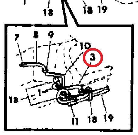

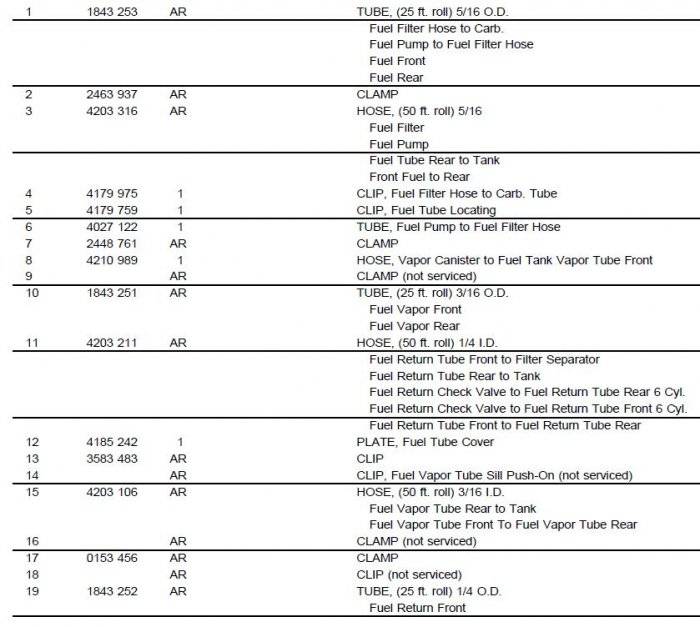

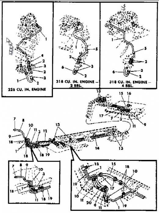

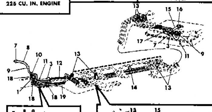

Most FMJ cars also has a hidden fuel hose that is hard to get to. You have to remove the Right Front tire to get to it. It is on top of the frame rail where it meets the firewall. That short piece of hose (about the length of fuel filter hose) has caused more than one mechanic to lose hair over it.
The pictures below is hard to see (the best copy I have) and it is the Red Circle in picture.
Expanded view of picture above.
Another expanded view of picture above.
This is from my ’82 parts book and should be the same as your ’80 Cordoba.
