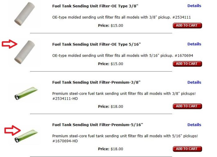

I shudder to say this - but it can be cleaned - but I wouldn't want to do it.
From this web site I found
http://billrolikenterprises.com/products.asp?cat=23&pg=14
There might be a lot of other places to get this filter – or as some people call “socks”.
They are mainly to keep the big stuff out.
What I find is they fall apart over time – leaving you with “no filter” – which is why I’m strongly recommending you replace it.
Now you know what to look for and its size (5/16”) there might be other sources for this part.
Note: I'm not going to twist your arm. Your car does have a primary fuel filter already and you might be able to get by without it or even cleaning it.

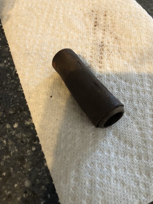

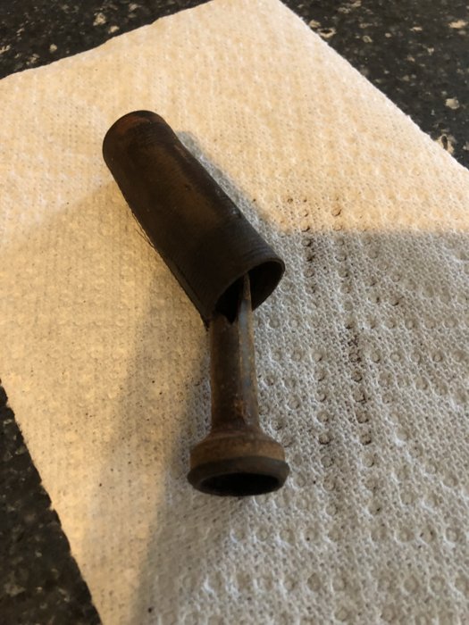

Well - filter collapsed in my hand. So I’ll need to either go no filter or replace it.
Not expensive though so probably get a new one.

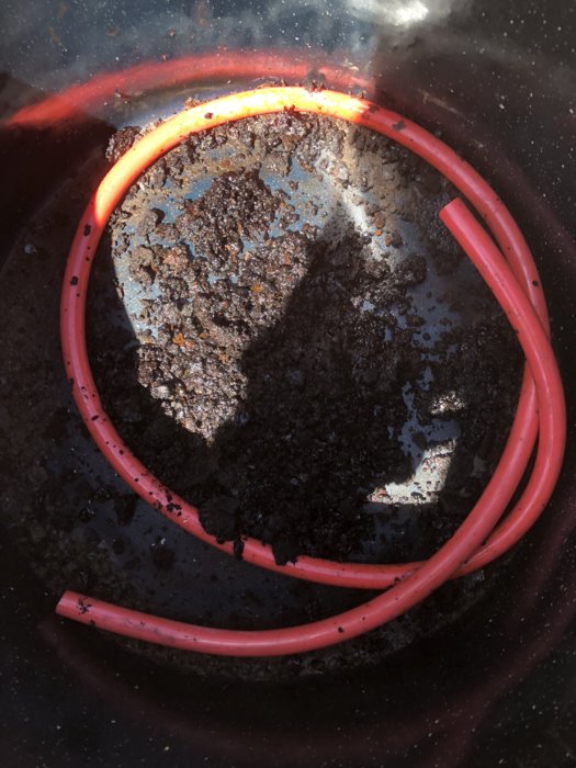

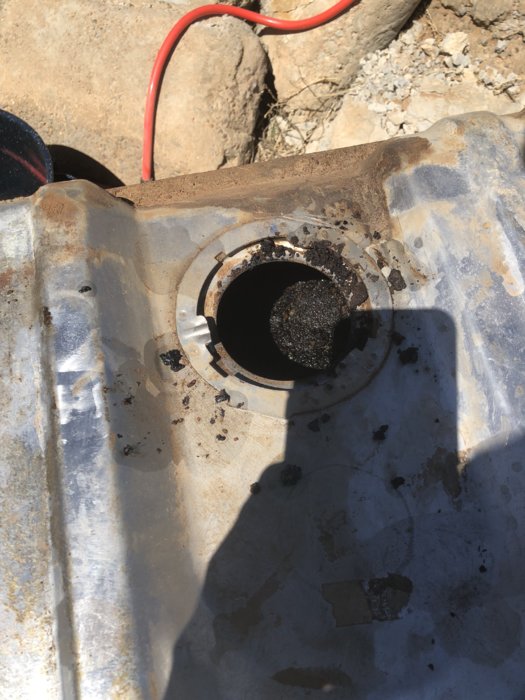

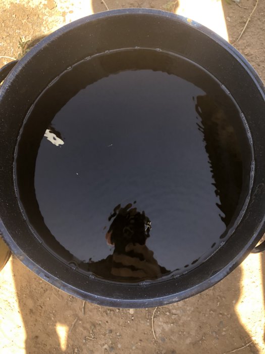

Solved one problem for sure.. I got to finish cleaning out the tank... this was a few days ago..
Liquid pictured is a almost black red “gas”.. was 7 gallons of it in the tank.
Sludge at bottom of tank was roughly a half inch thick - I was pulling out handfuls after draining the tank. I let it dry for 3 days, dropped it a couple times on dirt and shook out 80% of the gunk. Hoping I can get away with a good rinse at a car wash and be up and running.
Gross!
For what I can see of the outside of your fuel tank, it looks pretty good (based off of the last picture of above post).
Cheap gas, as well as ethanol (10% alcohol) does contribute to “gunk and sludge”.
Unless you go fuel injection – our cars do not/will not work well on 10% alcohol (ethanol).
The better grades of fuel has detergents in fuel that can leave a fuel system fairly clean (so a person doesn’t have to do what you are doing, again.
100% gasoline and get the good stuff (even though both do not agree with your pocket book),
Try to flush out the fuel lines (all three) – if you can, and I would recommend rebuilding or getting your existing carburetor rebuilt – for that same “gunk” will be inside of it.
