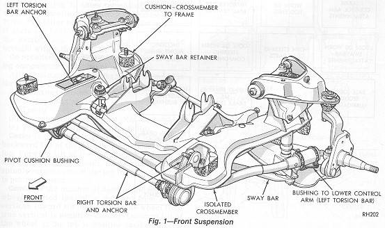

Enclosed below is a picture of the M body (pretty much the same as the F and J) transverse torsion bar suspension. Note the depth of the main cross memeber, the amount and size of the K member near the frame rails. All of this is what comines to keep the frame rails from moving (or becoming a Diamond Shape) during an accident. There is enough depth (front to back dimension of) in the cross member, and the forces are spread over a large enough distance that, should there be an offset frontal accident, one of the frame rails won't end up ahead or behind the other. This is what Ehrenberg was talking about.

I respect your opinion, but I don't necessarily agree with it. No matter how wide or deep the k-frame is, it still attaches to the frame rails at only four points, and in the case of the stock setup, there are thick rubber bushings between the k-frame and rail, which can't make for a very rigid connection. That being said, I am not saying this system is better than stock for safety or handling. I'm saying it is better than stock for installing a Hemi in a J body. I have found no other company anywhere that makes any Hemi conversion for F/M/J. And again, I can find nobody that has actually owned/driven a car with AlterKtion that has anything but good things to say about. I've spoken to several people with well over 15000 miles on their setup, without any problems. To me, that's a pretty good track record. No, it is not as time tested or engineered as the stock configuration, but for my application, it is the best option.
