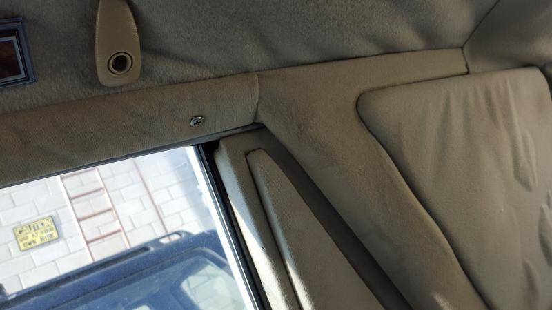

Could someone take a picture of the rear, inside, upper corner of the headliner where it meets the inside bonnet of the rear window for a 87 or so Chrysler Fifth Avenue.
Here is mine after I finished and installed it.
It looks goofy.
Is the bonnet supposed to meet even with the side rail that holds up the headliner? My side rail looks about 1/2 inch lower where it meets the rear bonnet.
Did you add the padded fabric to the trim? If so, the 3 pcs. overlapping could be causing the difference.

Yes I did add the fabric. since most of the interior was disintegrated I must have guessed wrong on when to cut even and when to fold over.

The holes that the machine screws go into are really sloppy. Just force the trim piece to line up, and force the machine screw in.

I am suffering greatly on the visors. For now, they are in the trunk. I thought the remaining trim would be easier to re-install. Ha ha.
I do spend a bit of time trying to line up the trim screw holes with the ones in the body. And of course, the stainless steel screws I bought (same size as removed) are sometimes too small because of the sloppiness.
