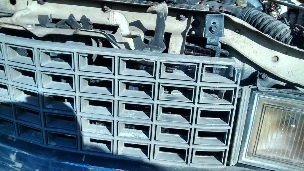

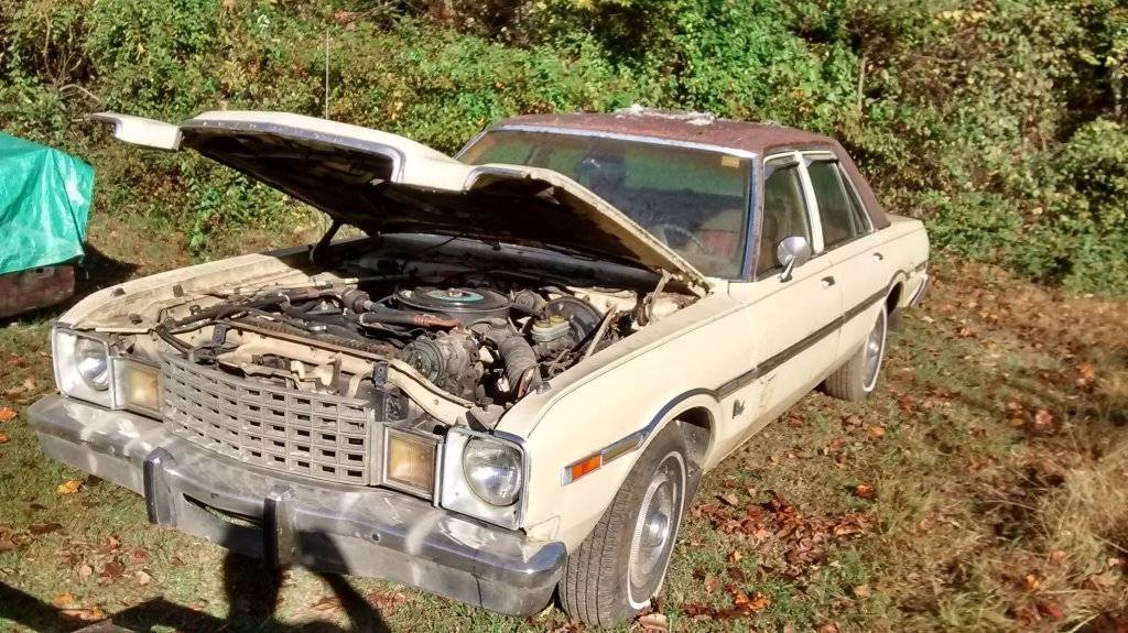

I have a couple of questions about the volare grille.
1. Could someone post a picture of the front of your car with the grille in place.
2. Could I get a picture of the backside of the grille (as best you can) while it is installed in the car?
3. What is the mechanism that looks kinda like a hood latch (sideways) on the backside of the grille?
4. What would improve the design of the grille... problem areas you routinely see?
As a refresher, here are the original pictures from the seller (Know Nothing) on this forum:
The thumb latch on the driver side that is in the 1st hole on the second from the top row has a short rod to the hood release. What I don't know is if it was in lieu of an under dashboard release cable? None of my F body cars had the thumb release, but I have grabbed grilles that had what was left of them.

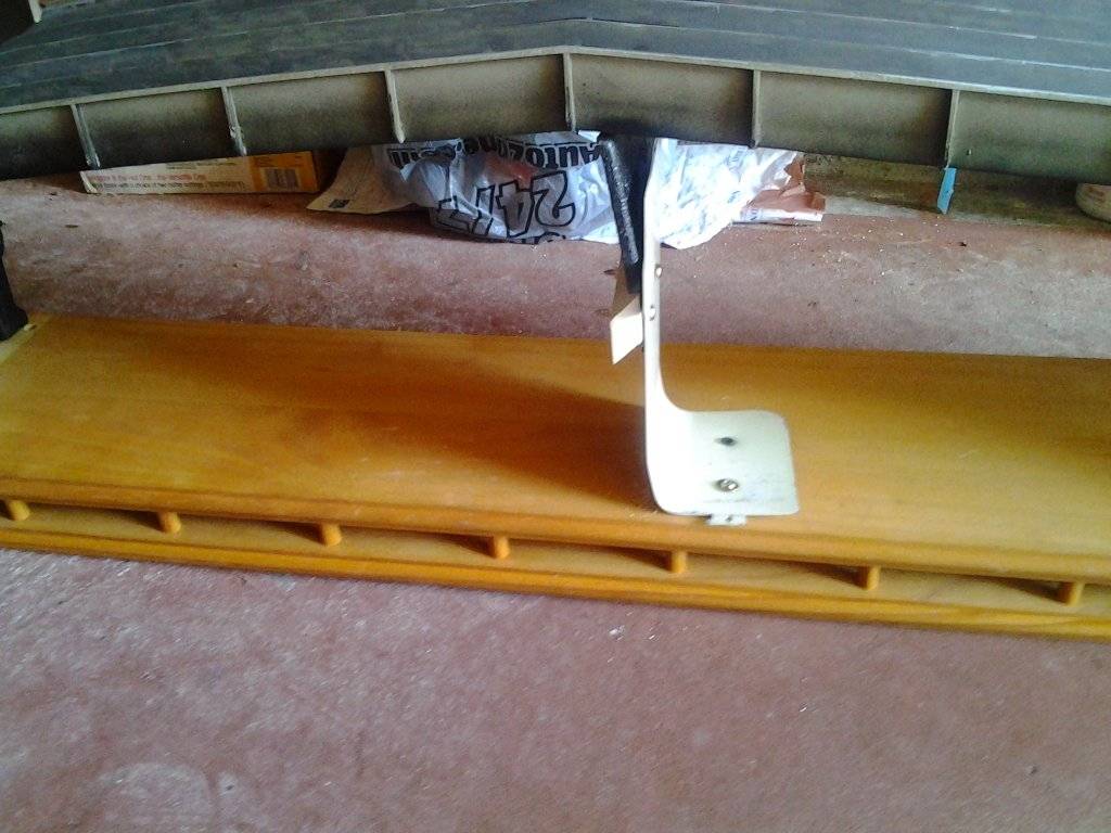

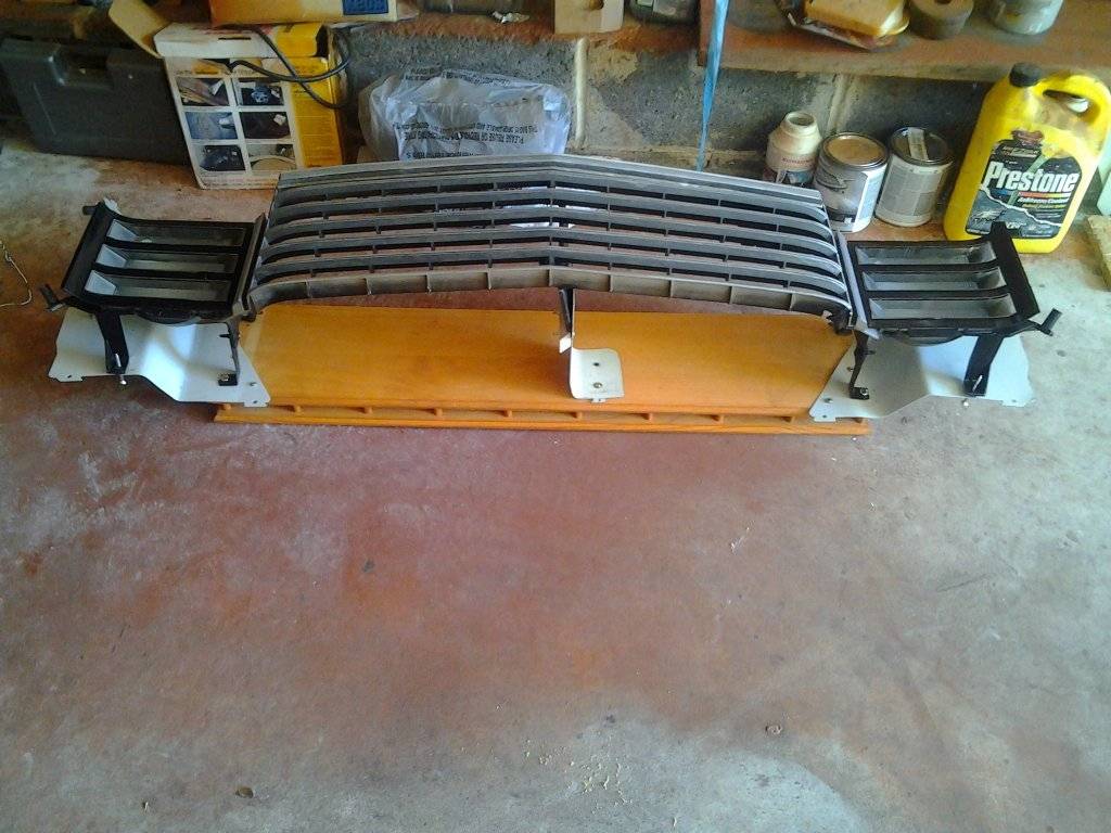

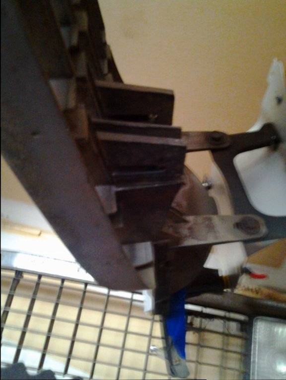

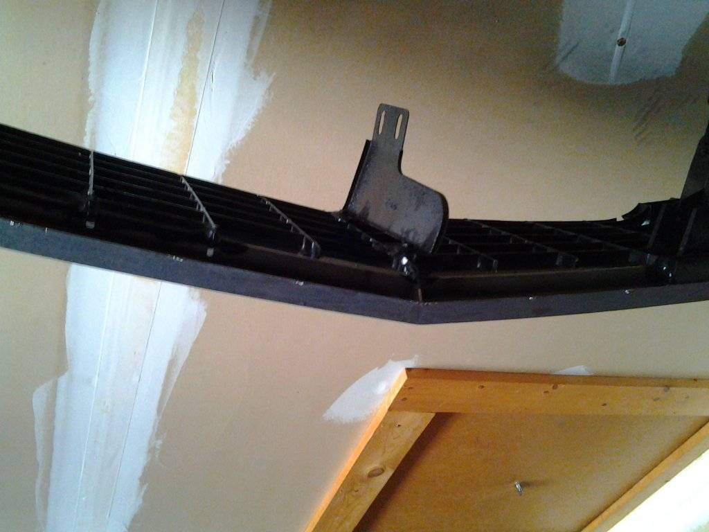

There are 3 mounting points per side. There are metal horseshoe brackets that mate the grille to the rad support- those are 2 of the mount points. Then one plastic tab (either side)
Even though the second pic is my aspen grille, the mount is the same. Where the silver wood screw comes up is through the plast tab mounting point.
The center mount

The in grille hood release was standard (my car originally came with it) and the under dash release was an option or part of certain option packages.

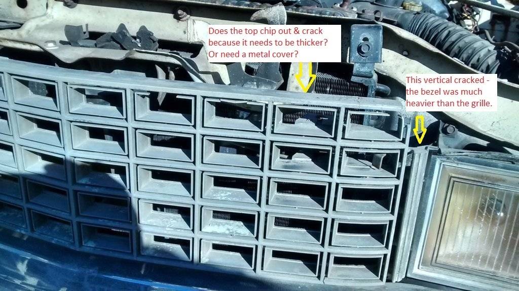

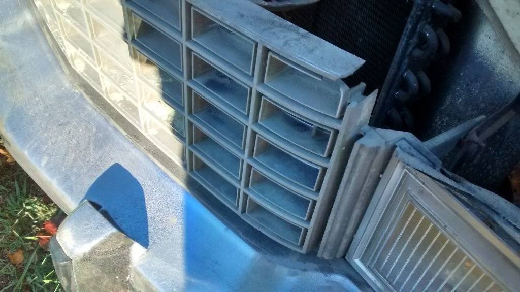

Tell me what you have the most problems with on breakage.
Just like BudW said, the grille that KnowNothing shipped me got here in 2 pieces instead of 1.
It appears that the area where the light bezel connects to the side of the grille is a very weak.
Also, all along the bottom about every 6 to 8 inches, and across the top were cracks from front to back.
What was the original, non-oxidized color?

What I think is they are made a bit thin, but (IMO) the material they used was way inferior to what they could have used. If a person could find (or make a new one) a mold and recast with a different material – would be the best thing.
If a person could repop these beauties, they would have a lot of business.

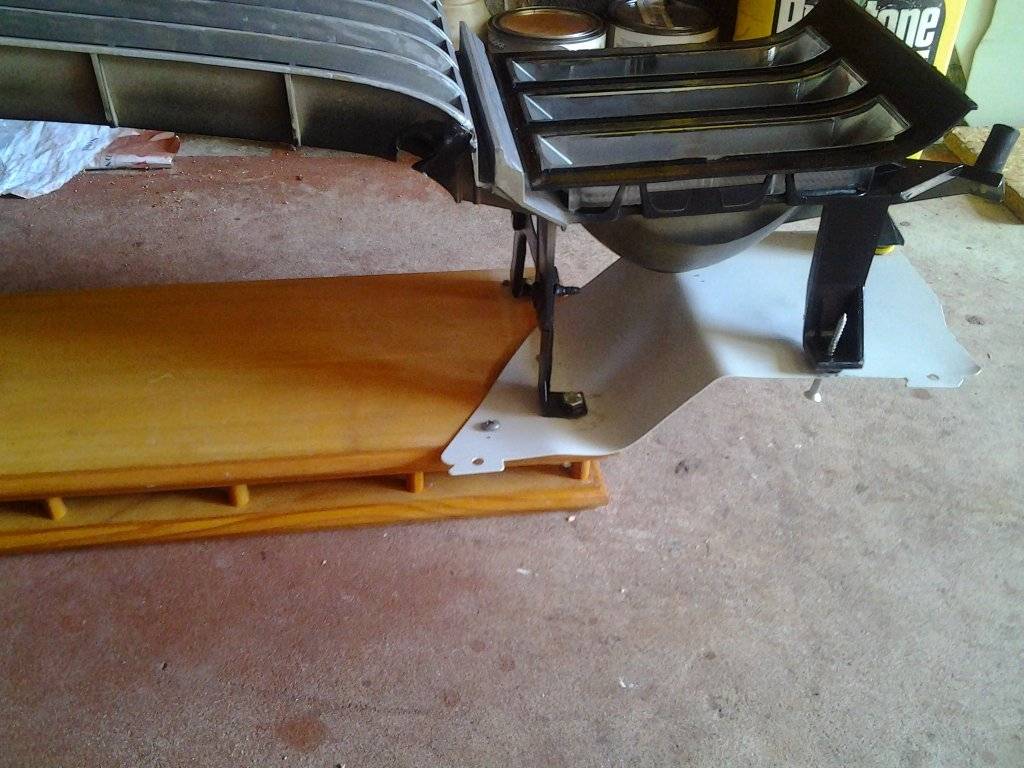

In terms of weak points: The 78 and 79 Plymouth is the weakest, followed by 78/79 Aspen. The 78/79 Plymouth grille will fold in the middle under its own weight. As to why, I built the jig. The ends are heavy- too heavy for the middle. The inner squares- brittle. One hack improvement, build some behind the scenes trusses from right to left. Building up material out of other donor grille pieces. The tuna can with a small amount of acetone in it will serve as a mixer. Add shavings of plastic (even black pvc pipe from the hardware store works). Build up the paste and then add to the grille.

The grille seems like it is more 'empty space' than structure. It seems as if the designer decided the 'sprue' from the injection mold was going to be the grille and thus is too delicate for normal usage.

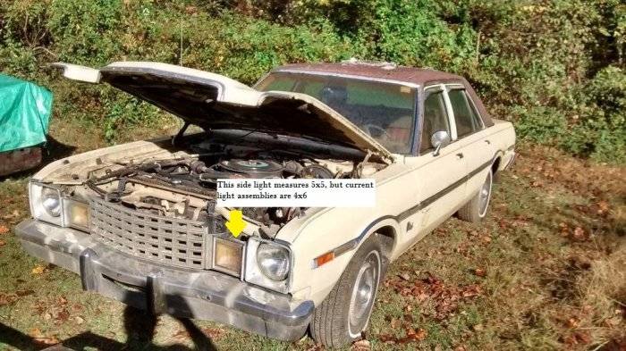

So the grille I got managed to get here in 2 pieces.
no surprise there.
It broke where the side light bezel connects to the egg crate grille.
It seems to be (what now is considered) an odd size - 5x5 square.
4x6 assemblies are easily found.
The covering lens is 5x5. So do you think a 4x6 retrofitted into that space would look horrendous?
pictures?
I'm not sure what you mean by 5x5 or 4x6.
Actually, I do, but not in this case.
Could that be the difference between years and/or Dodge vs. Plymouth?

I've not tried it, but I think the 78/79 Volare lense will interchange with the 78/79 Aspen lense.

The 78-79 lenses do interchange. I'm thinking OP has confused availability of the rectangular 76-77 Volare "crosshair" lenses with the later ones which are square. That or the 80 only, which are again, not compatible.
