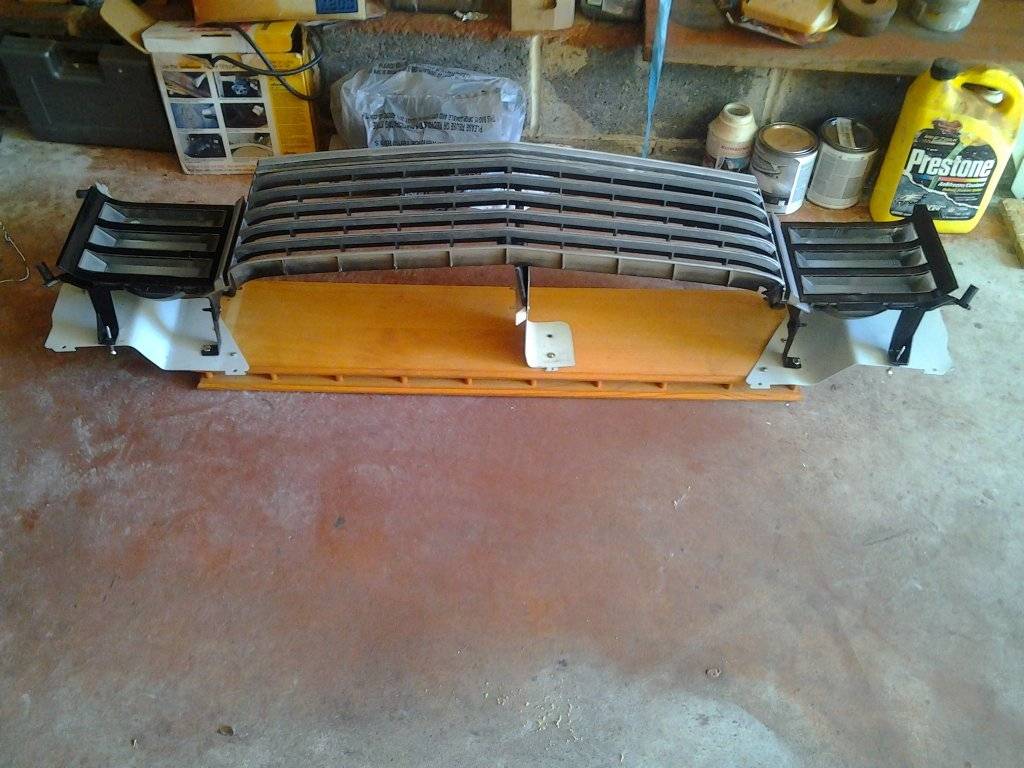

So I have been wanting to construct a jig that would simulate the front of an F body.
so here it is

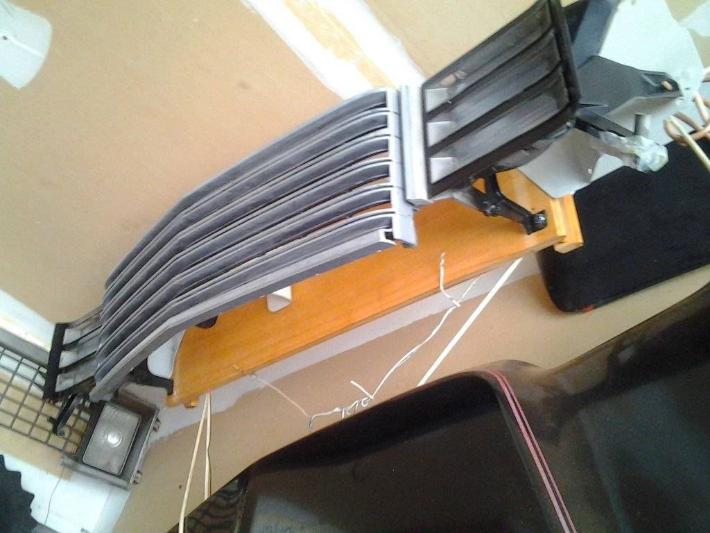

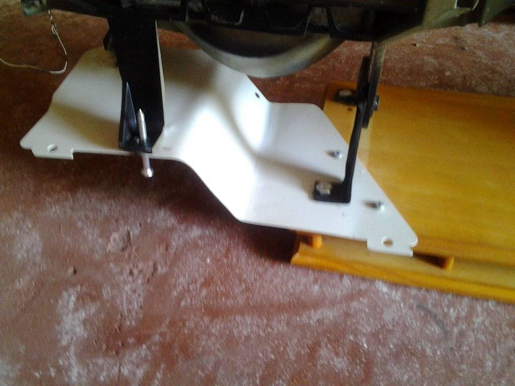

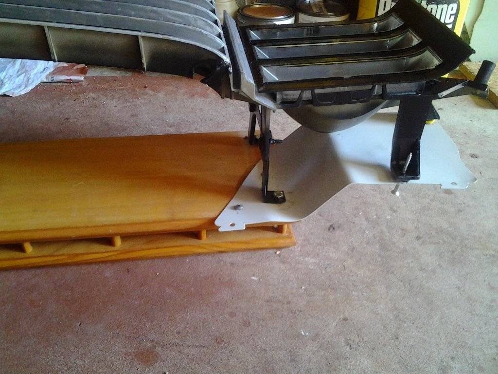

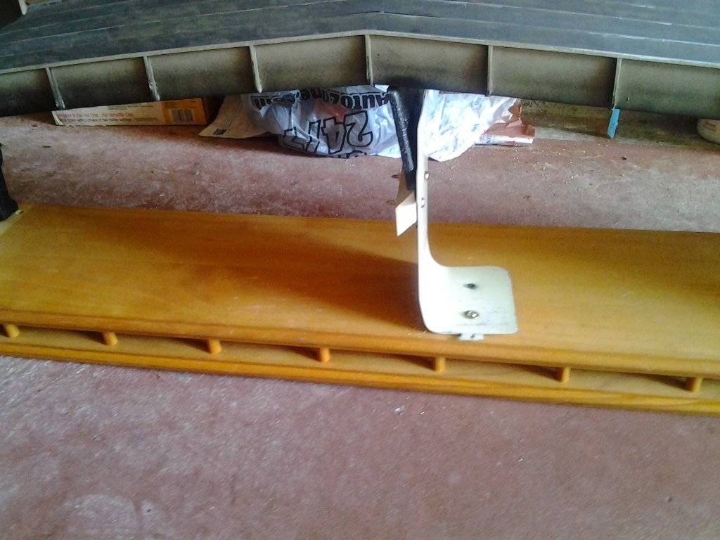

This allows me to lay it on a work bench or hang up my work to dry. It supports the weight of the grille and keeps it from collapsing in on itself. I took my known "good" grille as a mock up. This will allow grilles in 3 and 4 pieces a return to home position for the reconstructive surgery.

That jig is how they need to be stored. As you said, the weight of the grille, which isn't much, will deform it.
Fragile is an understatement. I'm always afraid I'll hit a fly and break a piece out. Seriously. Mine is half Gorilla Super Glue and epoxy I think. Everytime I look,,,,,,,,another crack.:( Also had to CAREFULLY bolt it on and slowly draw the parking lights in as it was warped (like too straight across). The center was good and the ends stuck out at least 1/2". Talk about a tense procedure!:eek: It was an NOS piece I got about 15 years ago from Marty and only been on the car since 2012 so it's not like it's been in the weather and sun very much. Probably why it's so hard to find a used '78/'79 grille that isn't broken or missing entire chunks.
That 78 Volare Grille is the most flimsy yet. I'll sure it up the best I can and then store it on the Jig or make another jig in a protective box

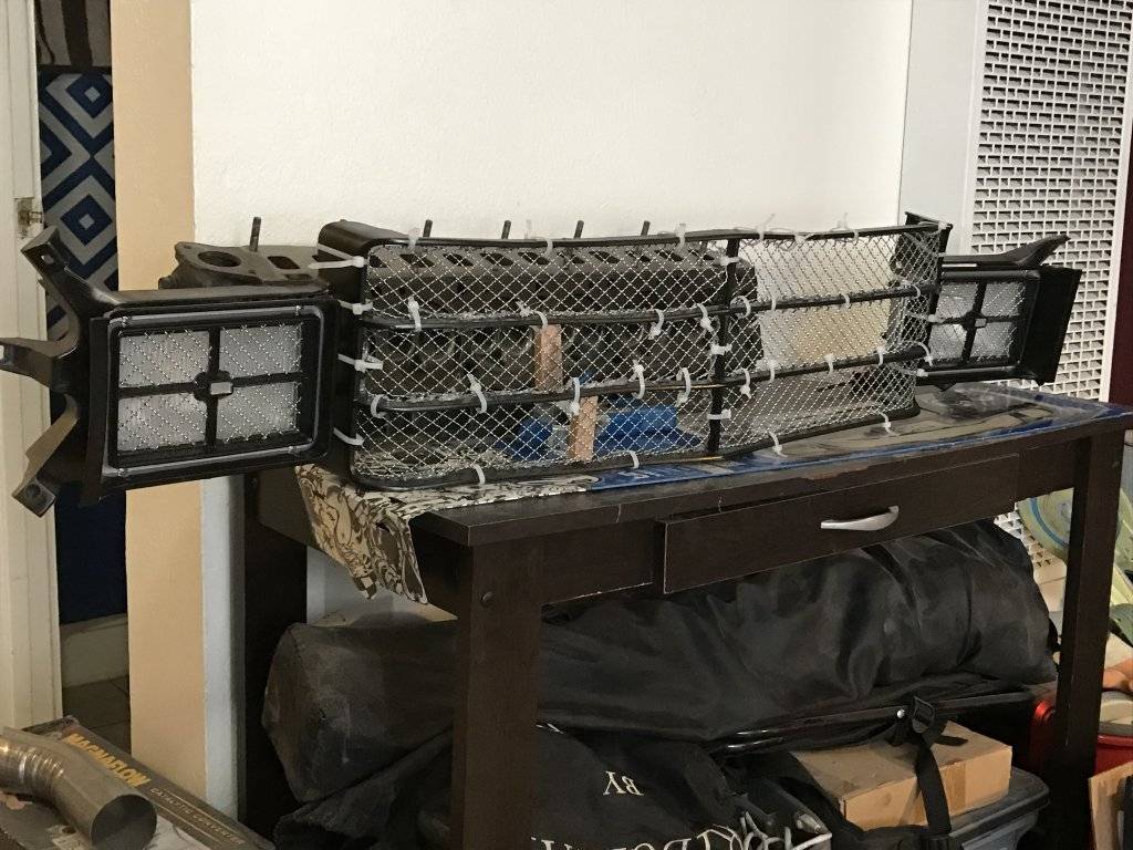

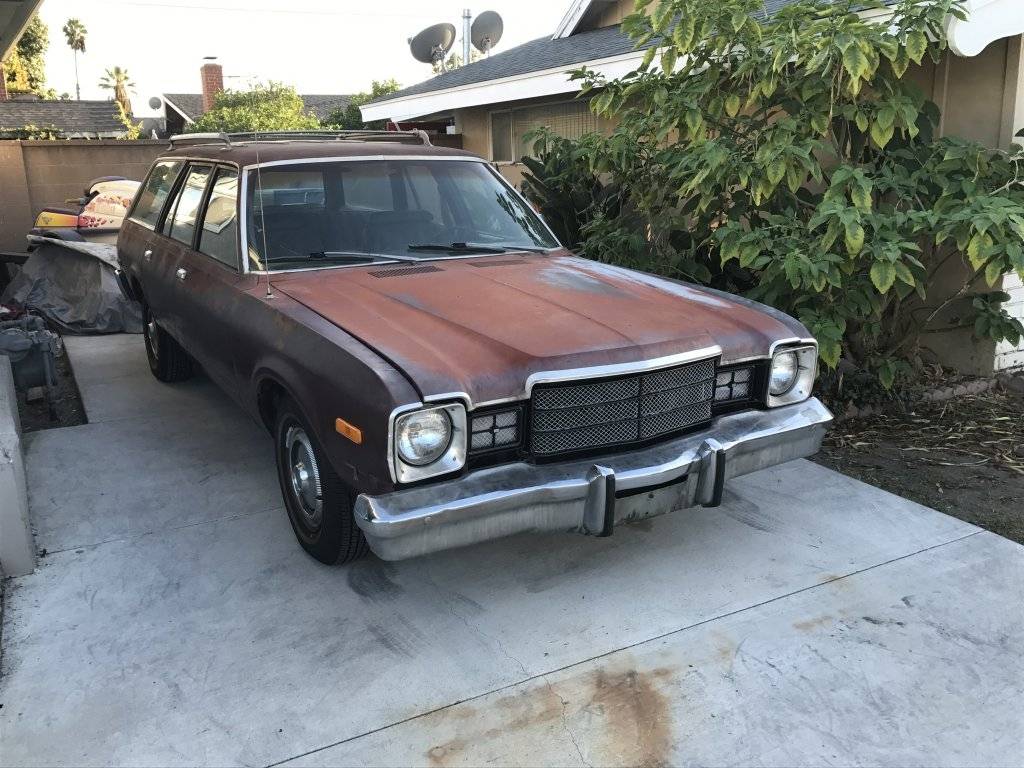

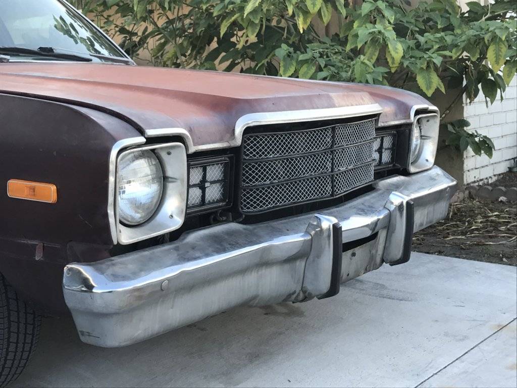

Just finished my own grill repair for my 77 wagon. I looked around online and could only find two suitable replacement grills. Both out of my price range, one was $800 and the other $300.
So I decided to use The original which actually broke into three pieces when I began removing it and fixing it. I used plastic epoxy to glue it all back together and I purchased an aftermarket grill kit.
I'll tell you what it's been hell trying to make it work, It still looks pretty rough but it's a far cry from what it was.
I know what you mean. That's why I built the jig. It keeps the work secure and stops it from walking all over the work bench. Try utilizing the plastic shavings with some acetone to build a cement that hold better than anything. use an old tuna can to mix it or low wide glass jar.
Still that looks great
