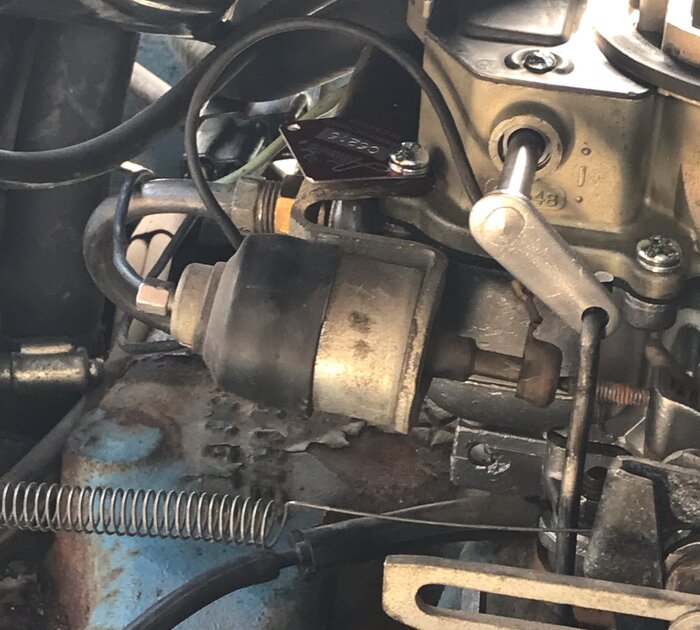

I replaced my Carter Carb with a rebuilt Autoline C6216. Swapped right in, but we're struggling to keep it going at idle. Looks like the dashpot is misbehaving (had to swap that over).
I have the 318 Lean Burn (yes, still have it) in my 81 Cordoba Convertible and I'm wondering is there something out there that I can use in place of the OEM dashpot? Pic included of current dashpot.

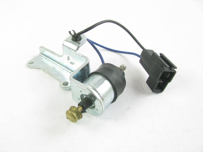

BIG THANKS! Great idea with eBay. The one you suggested wasn't exact, but looks like I found one on eBay - Carter 213-217. Mine is for Lean Burn, so notice the connector in the back left of my picture when you follow the wire. This one looks right on. Let's hope it works. Thanks again!
