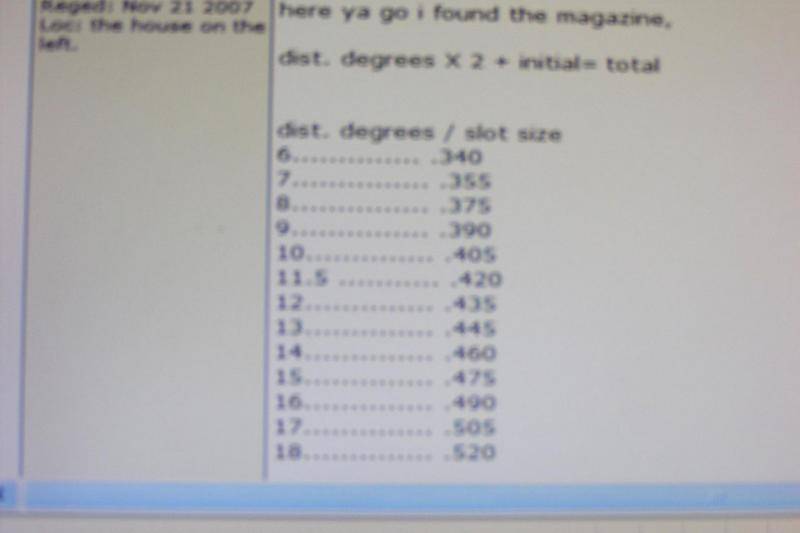

gtsdude
Aug 1, 2012
94
16
SE MN
Here is one I found on the net, should get you close.
7,085
That's the chart I was looking for! Still no idea what happened to it......................................
If you don't have one, get a digital caliper. Even the $20 ones at Harbor Freight are accurate to within .001"
After taking the dizzy apart (and swearing many times with that tiny, frustrating little circlip that hold the plate to the shaft.....at least with my 50 year old eyes, lol) use a MIG welder and add just a hair of material. Then use a small, square file to clean it up and get to the size you need. If you knew all of that already, never mind! :)
