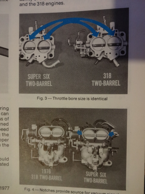

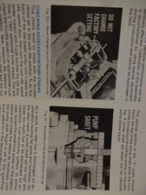

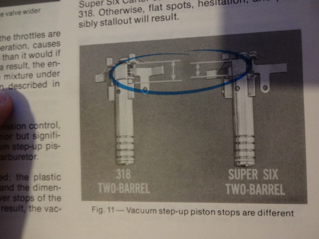

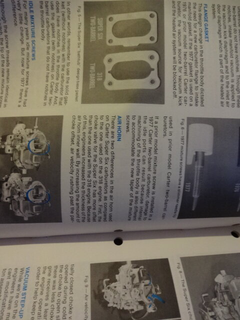

There is a good bit of factory lit on what will and what wont interchange in the 225 2bbl vs the 318 2bbl.
A holley 2280 in 78 on the 318, ive never seen one up close.
If this would help I could scan it.
The /6 Carter BBD looks similar to the BBD used on 318's - but, for the most part, that is about all. Most all of the parts are different between the /6 and 318 BBD's.
That said, I believe the rated CFM for both, are the same.
If you really want more CFM, I might suggest a larger carburetor like the one used for 360/383/400 2-bbl or something like that (which uses a wider mounting flange) - but not sure it will be that much more help in the long run. Without forced air (turbo or supercharger) and/or without major modifications, I don't think a /6 will flow that much more air the existing BBD will flow (but could be wrong).
Every engine I've seen on a dyno will show it's highest VE at peek torque and for a stock motor that's only 80 to 85 percent efficiency. It's only after better a better exhaust, intake and usually a cam do you need a larger carburetor.
For a slant six peek torque is in the 3000 rpm range with little hp increase after 4000 rpm.
1,634
426
This is straight from chrysler 1976, looks like the greenies were at it then as well.
But like any 78 T quad even... for performance they belong in the replacement carbs box.
Id start looking for a 2bbintake and a /6 header if I were really trying or you can still from time to time find a performance cam that does make even a smog setup run a hair better.
