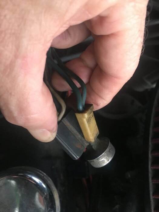

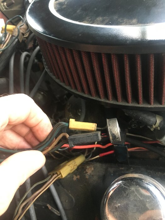

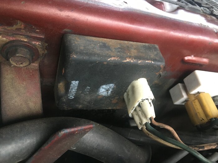

The black box on the firewall with the tree-prong connector is either an EGR Delay Timer or an EGR Delay Selenoid, although that being an epoxy selead box I'm thinking it's the Timer.

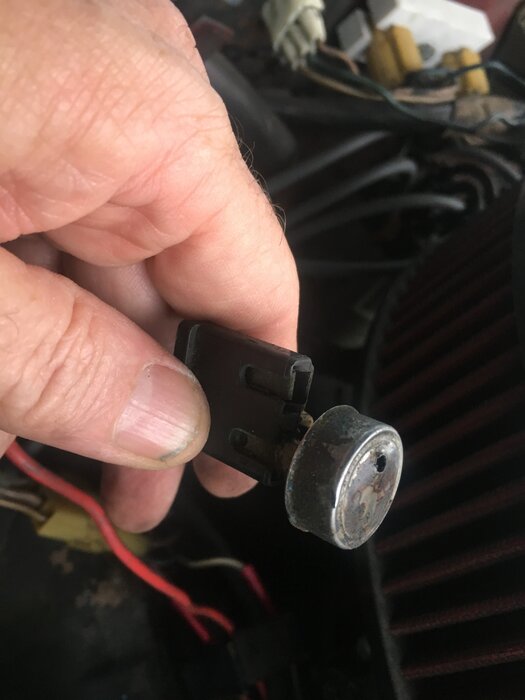

The round thing is part of the Electric Choke Assist system. Basically there are two types: Single Stage (which is just the round puck) or the Dual Stage (which has the round puck as well as a resistor). The puck itself is spot-welded to a little metal bracket that bolts to a manifold. Looks like that metal bracket was torn off of the puck, which is why you see that little hole in the bottom of the puck.
Anyways, the difference between the two systems is that the Dual Stage differentiates between Summer and Winter requirements (resistor controls the Winter duration), whereas the Single stage is just that, a single mode for both.
The weirdest part I see in your pics is that two-pronged connector on the Electric Choke puck. To me (and my memory is a little fuzzy) that connector looks a lot more like the connector for the windshield washer fluid level sensor....ughhh????

The flat connector isn't supposed to be on the choke puck. To me it looks like a connector for a low washer fluid sensor (possibly). As for the other things, I'll have to think on them a while.

Thanks Guys, If the lean burn system is gone...Is the EGR delay box doing anything ?? is the electric choke assist doing anything. My carb has electric choke on the carb...
1,439
581
The egr box I believe is independent of the computer. But you can get rid of it if you have a vacuum switch on the the front of the intake to interrupt the egr vacuum. It does the same type of thing and won't let vacuum thru till the engine hits a certain temp.
I noticed that too on the choke plug. It might also be for the vacuum amplifier or solenoid. I don't remember what those look like now. It also looks like cruise control plug but that wouldn't be on top of engine. But no, having aftermarket carb with electric choke you can get rid of those parts and connect choke power to where edelbrock recommends.

Most '77 F-bodies did not get Lean Burn (a small amount did, though). Where as most '77 M-bodies did get lean burn (with a small amount that did not). I would be highly surprised if your car did come with Lean Burn.
Your pictures look as if it came without Lean Burn (IMO).

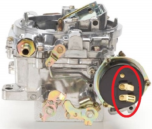

The choke switch should be grounded. The choke switch power source gets constant 12v when car is switched "ON". The power supply for choke switch might be a good 12v source, but is not the correct wire. The correct wire should be a single wire and looks exactly like one going to choke thermostat.
I'm not sure if you can reattach the choke switch bracket back onto the can. If you can, great, but it might be easier to find another choke switch just like the one you have.
Can you take a few more pictures like what you did, above, and post, as well as both sides of the carburetor, please?

If your Edelbrock carburetor has its own choke thermostat, that is not electric, then yes - that choke switch can be tossed. If your carb's choke is electric, then a (switched via ignition) 12v power source is needed.
