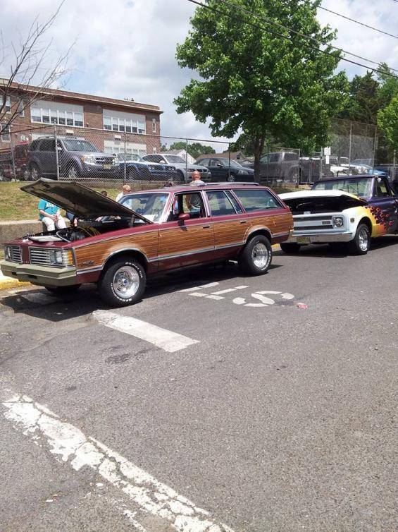

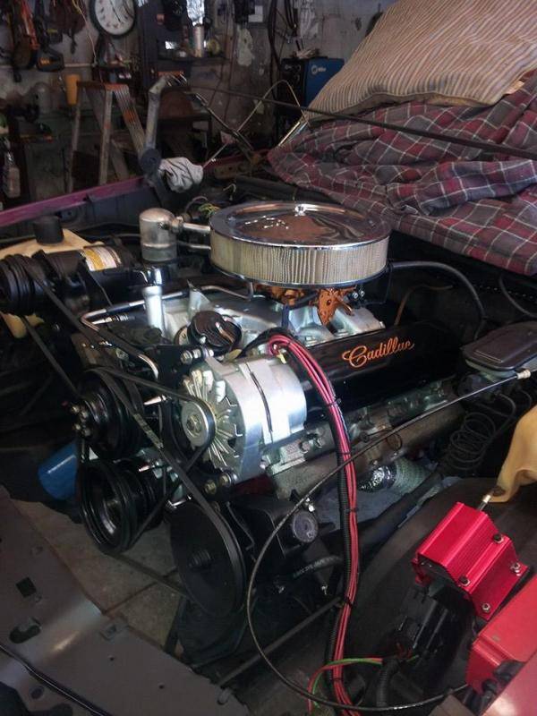

I happened onto something yesterday. My budy runs a caddy 429 in an 81 Pontiac Safari G body wagon. He runs the same 750 Edelbrock with the E choke as me. He noticed at cruising speed the engine starts to heat climb. Similar to what I see, grant it I'm running a mopar small block. We both run a stout gear and pretty tall tire 28 inch. his is a 4:11 in a Ford explorer 8.8. My 4:30 in and 8 1/4. So 55 mph is a scream for both of us.
So, my budy is getting the carb kit with different metering rods (smaller ones and then taller ones). He believes the secondaries are "leaning out" at cruising speed and needs to rich them up.

Just had to post because it is a work of art.... I know it ain't mopar, but I'm checking a woody wagon M body today and this Pontiac is edging me on "TO BUILD A MOPAR WOODY WAGON MONSTER"
