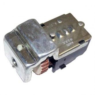

This is a photo of the top side of the headlight switch. Notice the small metal button in the center of the switch. This will be on the top side as it is mounted in the instrument panel. That's what you push down before pulling out the knob.
