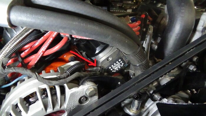

This the ignition on my Aspen for reference.

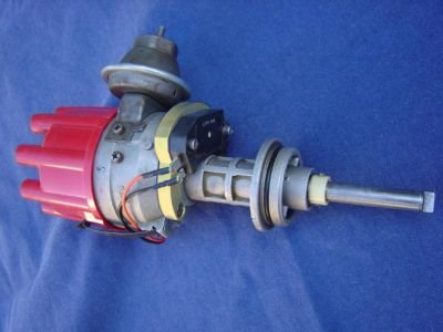

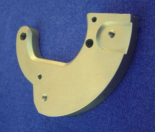

I always liked this setup. Uses a standard GM HEI module. This is what I would be using if I didn't want a rev limiter and computer timing control.
Mopar HEI Conversion
1,430
577
That's a cool plate to hold the HEI. I've always stuck with the mopar setup.
View attachment 45694View attachment 45695
That looks like a good way to go. Never saw one of those before.
