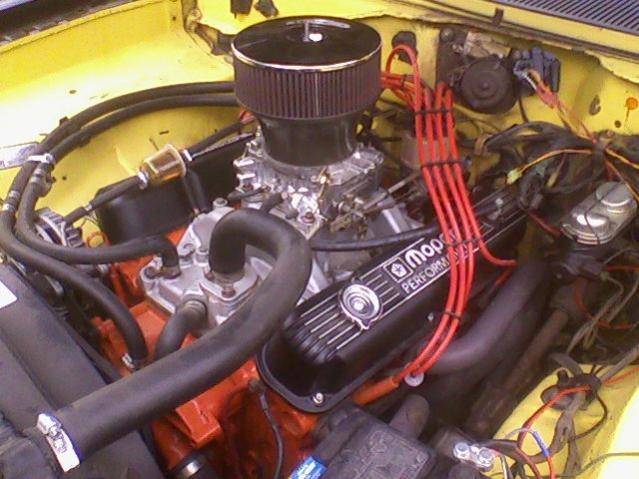

ive been thinking and looking and compareing my two 318s the one in the valiant is a stock 73 block 273 rockers i beleave and edel proformer intake 600edel 4barrel accel super coil round air cleaner.

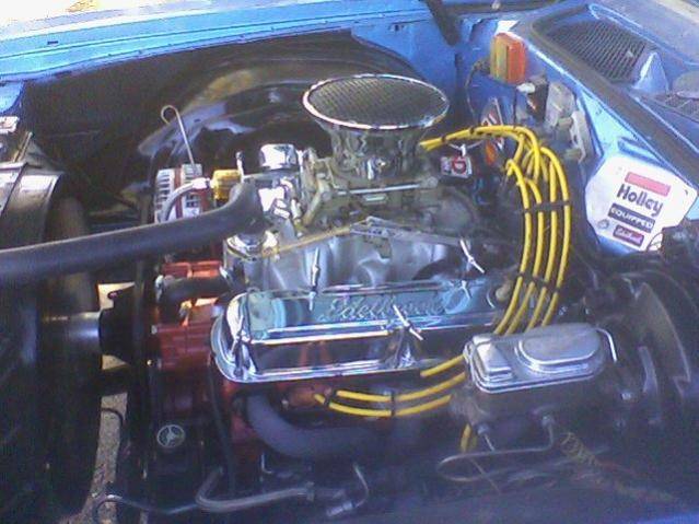

aspen stock block edel intake 650 edel 4 barrel accel super stock coil stock air intake and air cleaner.
im wondering what makes the aspen seem so slow and less proformance im wondering if the air cleaner would help anything getting rid of the stock one. other obvious stuff would be better im just wondering if its possibly restricting.
