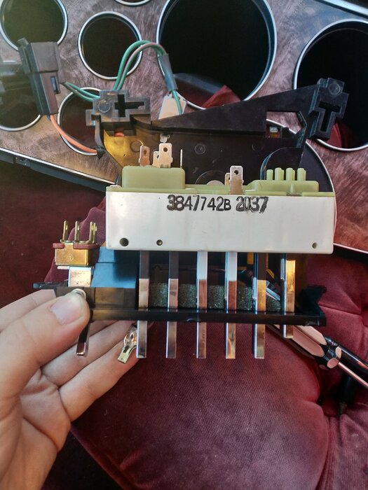

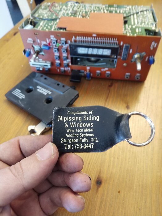

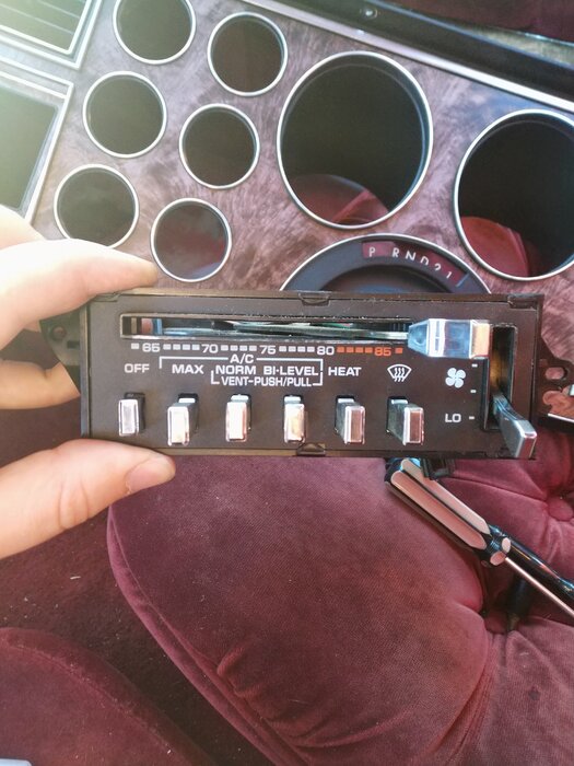

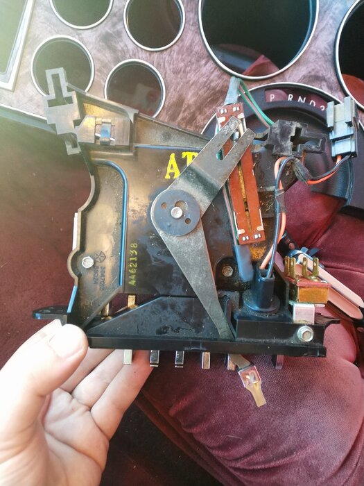

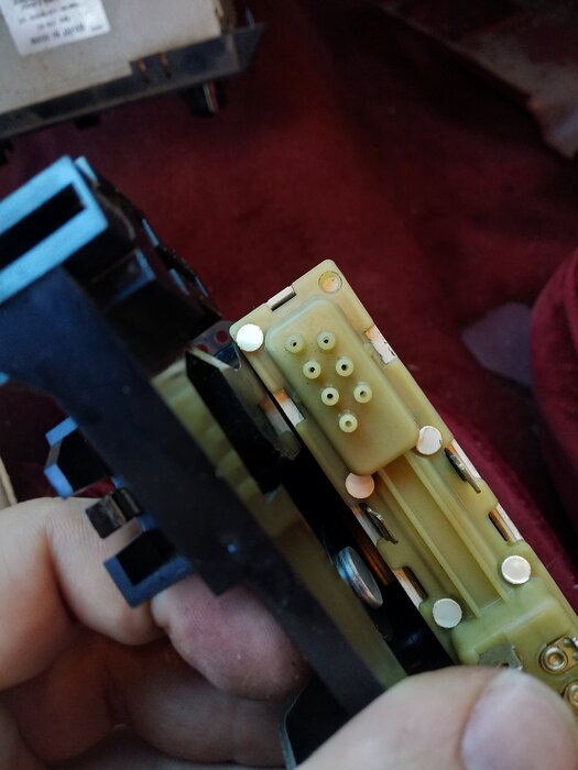

Pulled the radio and climate control module, solved my speaker concern. For the climate control, if I plug the vacuum lines with my thumb there is no hissing, but when I connect it to the module it does, should I disassemble the module?

the vacuum switch assembly has gone bad. I think there are new ones available, but are pricey
Thanks for the reply, I had another listen and the hissing noise wasn't coming from the unit itself, so I began manipulating the vacuum hoses and even though that green one appeared intact I could change the hissing. I bypassed the connector with vacuum hose and there is no more hissing.
I still have no heat though. Any suggestions? The heater hoses going in and out the firewall are both hot. In the meantime I am going to disassemble the head unit to remove a stubborn cassette.

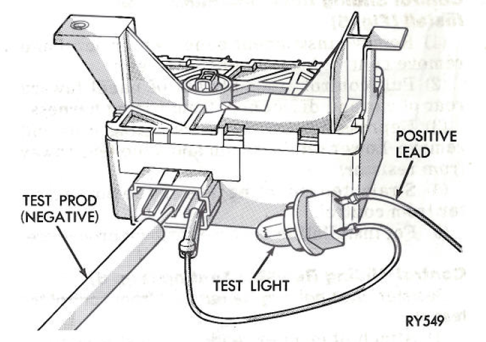

The blend door stopped working on my 5A shortly after replacing the heater core. The plug actually failed to make a proper connection as there was no tension left in the plug itself.
You can test this by playing around with the plug and running the temp slider from side to side. That door should move with every adjustment of the temp slider.
If it is the plug, I just took the servo apart, scuffed the pins a little and built them up with solder. Made the plug nice and snug again. This can all be done WITHOUT removing the heater box. It's tight, but doable. Let me know if you need help.
