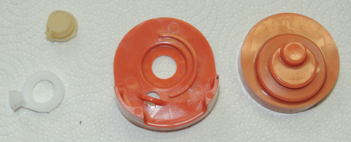

Take a look at what parts (or remains) you have.
Many of these just became available as re-pops: (note: the original pictures are less than desirable)
1980, 1981, 1982, 1983 Chrysler Cordoba Dodge Mirada windshield wiper repair kit | eBay
What I think you should have.

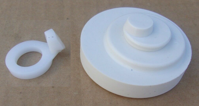

NEW 1976-1980 Aspen Volare 2 Speed Intermittent Windshield Wiper Cam Bushing Kit | eBay

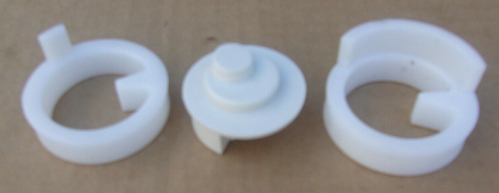

One other option.
New 1977 1978 Diplomat Lebaron 2 Speed Windshield Wiper Cam Bushing Kit | eBay
A third option.

Or do you only need the bushings that go in the holes on the linkages, which are also available?
The bushing on top picture, Left top item is the bushing used for other three bushings - which can also be a problem.
The other three items on top most picture (post #2) are for the short arm from wiper motor. The three small bushings are for the rest of the wiper links.
