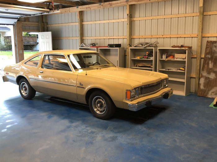

I just inherited a 1980 volare coupe with 100k original miles on it. Originally bought new by my grandma!

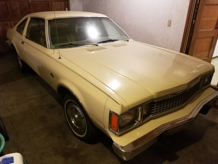

Welcome! That is a nice looking coupe. Looks to be in good shape. How about some more pics? Sorry about your grandmother, but she left you something to be proud of. I suggest that you simply drive it for a while to see what you have, what you like about it, and what you might want to change before making any unnecessary changes.

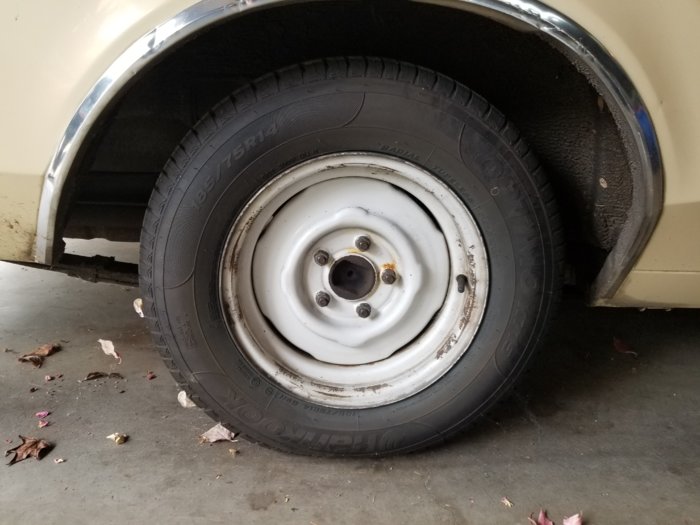

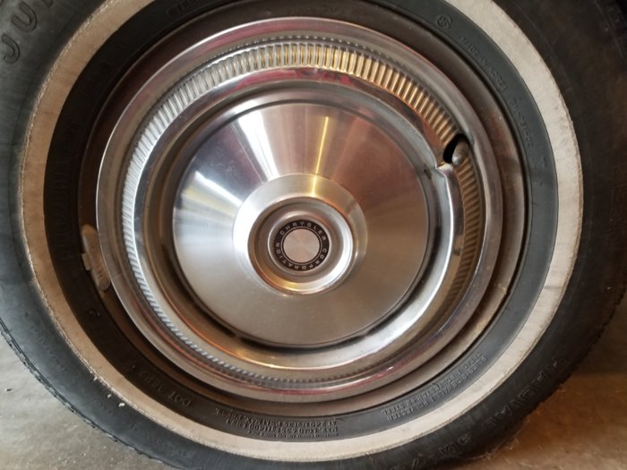

The car needs new tires badly. The wheels seem pretty rusty so I may need to get some new ones along with the tires. Also missing one hub cap. Anyone have any recommendations for tires/wheels?

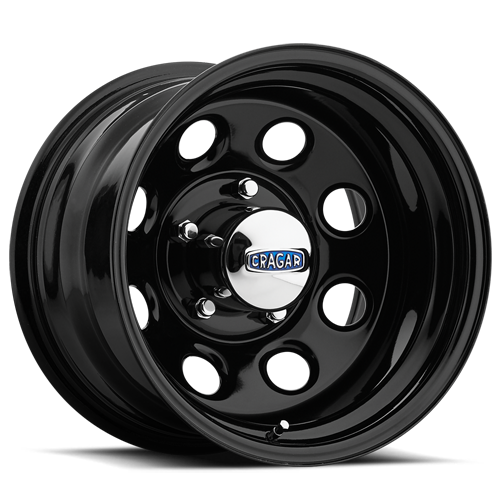

These would look pretty cool and they're not expensive:
Run a 235-60-15 tire or maybe even step up to a 16" rim/tire. Just whatever you don't go with different sized front and rears. The staggered setup looks tough, but not being able to rotate the tires on a car you intend to drive a lot will significantly lessen the life of the tires.

Here are some pictures of my current wheels and hubcaps. Are these stock?
